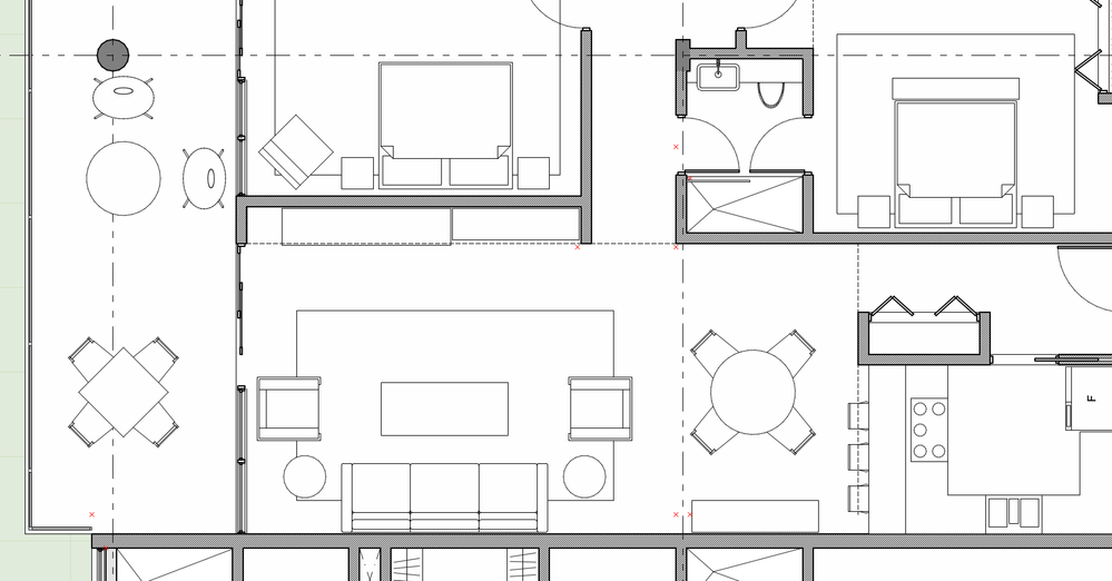

Back to the question, see a few examples. I'd like Archicad to act as a 2D programme as well, so that I have much better control on the result in terms of - see lots of unwanted lines here and there. I need to break things down to very simple layers which I can modify and work with on Photoshop after. First image is the result, the others are layers of
walls only and furniture only. If I want the walls to cast shadows I need to have walls only. But these look terrible with tons of unwanted lines etc. Perhaps my understanding is wrong, i just wish I could simply convert to 2d plans and do my stuff.

I get it and the main issue I see is that you are still learning AC but what you want to do is really simple since AC projects 2D automatically.
You don't need to export from the 3D window you need to make sure that the floor plan looks correct by turning layers off and then you can publish a PDF with Layers.
If you know how to use All-Plan it is basically the same concept you place 3D Objects in floor plan which you can see in 3D but to export you need to make sure the floor looks correct. AC cannot read your mind and produce it.
From the same project 2 quick floor plans.
2D Floor Plan
I can override the cut fill for the walls and turn off the grid lines etc
3D Document with shadows
I would overlay the previous one over this one to get the shadows.
