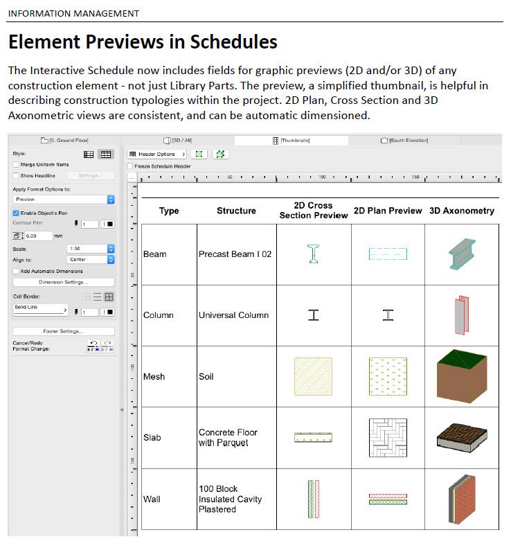

I'm not sure if this question is still actual, but adding an answer for anyone else looking for a solution.
I managed to find a way around it by making an 'off-layout' 'sample list' of walls, zooming in to this, then Document -> 'Save view and place on layout'.
Then one can use the usual in-layout text-tools to annotate each sample.
In version 20 you can add section, plan and 3D previews of the 3D elements (i.e. not for 2D fills) right there in the schedule.
