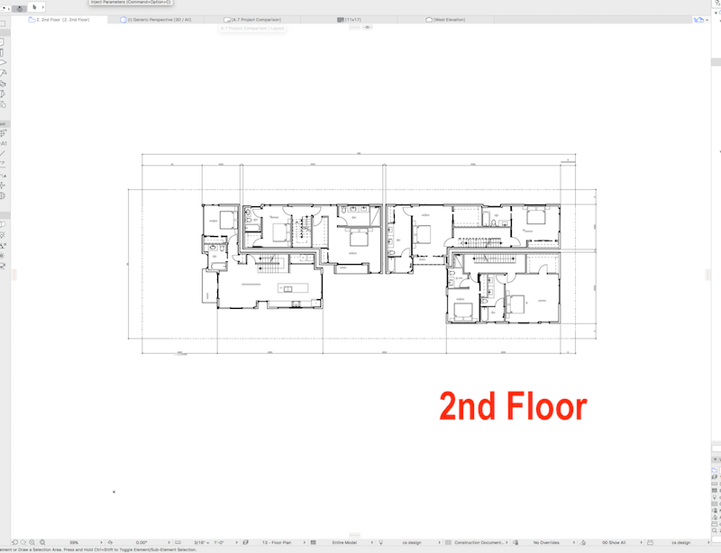

dcerezo
2nd Floor
ArchiCAD 26 - iMac 27, Late 2019, 3.7 GHz Intel Core i5, 32GB Ram, Radeon Pro 8GB, macOS Sonoma
