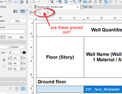

You will get more response if you put your images inline not attached.
Right now they have to be downloaded to view and that's likely to have less replies.  Putting the images inline will likely get you responses faster.
I can probably help, but I will not spend the time to download the images.
When you select an item in the schedule, Ar the buttons to select on floor plan or 3D greyed out?
If so, you have accessed the schedule from the Project Map with the zone layer turned off (or locked), or if you opened the schedule from the View Map, either the layer is off in the layer combination or the renovation filter is hiding the zones.
Make sure your zones are editable in plan, and then open the schedule from the Project Map.
If even that does not work, should you be scheduling the zone or the zone stamp (sorry I am unsure as I rarely use zones and even less finish schedules).

Did you check if the property for Wall base is enabled for the classifcation you are using?
https://help.graphisoft.com/AC/26/INT/index.htm#t=_AC26_Help%2F045_PropertiesClassifications%2F045_P...
Usually the "---" in your second screenshot is an indicatior for a wrong property availability dependet on classifications
