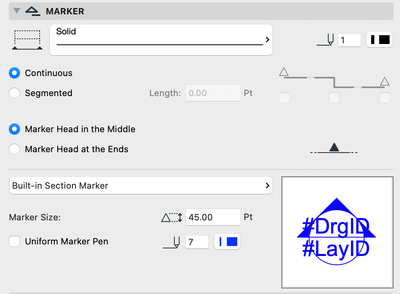

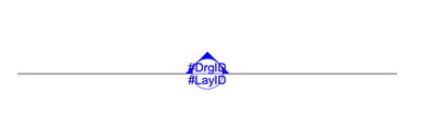

one possible work-around would be to use section markers instead of I/E or Elevation markers; set it to "Built-in Section Marker", which gives a setting for "Marker Head in the Middle", and shows the cut line as an extension of the marker.

Thank you for you proposal.
While this would be likely workable option in other, smaller context the reason we opted for the interior elevation was the option to use automatic naming via zones that doesn't seem to work with seperate elevations? This is large project (over 50000 m2 ) and we will be producing hundreds of room layouts with likely 2000+ elevations. While you can manage separate elevations en mass the IE seems more efficient/managabler in the respect as modifying group properties (naming/properties) automatically conveys changes to relevant sections at the same time.
This also tied to seperate printing file using PMK-references where accuracy with naming is essential and eliminating human error as much as possible in the process is always a plus.
