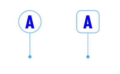

Hi, I'm trying to find a way to implement the new keynotes into my workflow.
Is there a way to create custom labels that display keynotes?
I need a vertically centered label, like a property label, but i can't use the default label and the other labels can't display keynote data.
Is there any way we can achieve this? Even with GDL.
Attached what i'm trying to achieve (where A is the keynote ID)

The closest I can get, is by rotating the label 90° anti-clockwise after straightening out the leader. However, the text is also rotated along with it, which is not what you're looking for. 😞

Thanks for trying. Yea, it looks like i have a choice of these two, ugly vs hard to read.
