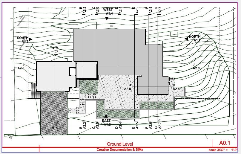

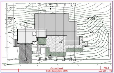

The text in the master is black but it shows as red in the Layout Book & Publisher set.
Any idea on how to correct this issue?

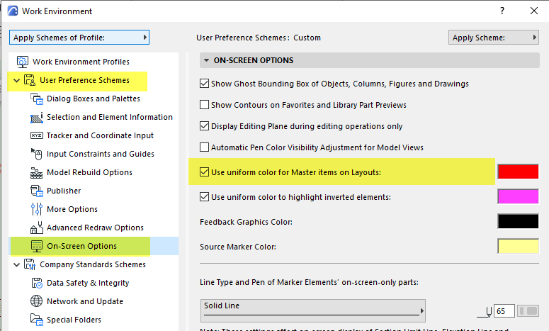

It is a Work Environment setting.
Simply so you can tell what is on the master layout as opposed to the layout itself.
It will all print in its correct colours.

It worked! Thank you, Barry!
