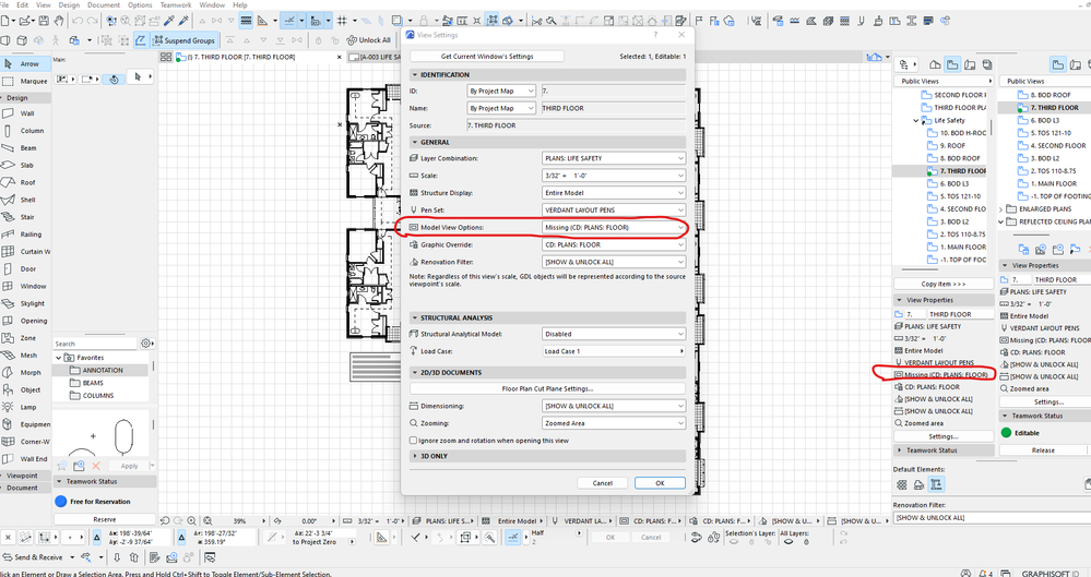

I was going to create a new issue, but I am going to weigh in on this thread instead since it does not appear to be resolved. We are running AC25 in a multi-user environment utilizing BIMcloud as a Service. We have been experiencing this issue for years. It appears to happen only in a Teamshare file. If a user creates a plan view and adds that view to a layout, then another user who opens that file will often, but not always, see that the model view is missing. It is always the Floor Plan MVO that is missing. Please see attached snip.
We do use a template that was created using a third party's template file as a go-by back in V20. We continually revise/update our template and are currently doing so for a V27 launch. I would love to have this problem resolved so we don't continue to waste time on it. Your comments would be appreciated.

if you have the latest build, it 'technicaly' has been fixed, in that once you run a repair on the file, it will not come back. The software has been fixed, but all files started from a build that produced this issue will retain the corruption.
The fix is:
-save a .pln
-open the .pln checking the "repair file" option
-go through the entire view map to fix all "Missing"
          (you can not use the drawing manager or view list for this, as they will only show as missing in the view settings)
-once all views have been repaired in the .pln, you can save it as a new file or upload to a bim server
I've had to run this repair on about 50+ files so far. It's a major pain, but I guess thats what I get paid for
