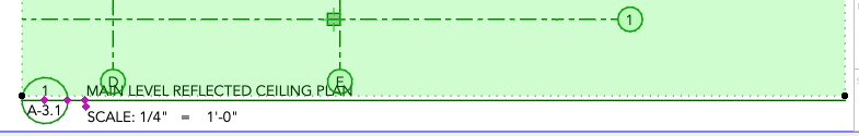

I have noticed that in AC27 the pre-loaded drawing titles don't work as smoothly as they did in the past. Specifically, when I use NCS Drawing Title 2 27, the Drawing Title and Scale will not stay aligned with the right side of my drawing. This was a function I appreciated in 24 & 26, previous versions I used, that allowed simple manipulation of layout tidiness.
Aligned nicely to right side of drawing extents:
Won't follow drawing extents on right side: 
It seems to work if I select the drawing title, and allow it to stay on the left side, but I cannot move it to the right.
Anyone know how? I've experimented with the other drawing titles, but not found what I'm looking for yet.

One option open to you is to edit the default drawing title object or create a new one.  I've done the former for aesthetic reasons, but I expect you may be able to address your needs in this way.
Here is an older, but helpful video of creating a new one:  https://www.youtube.com/watch?v=4fup76cQOiM .  Basically, as an object, you have many options open to you.
