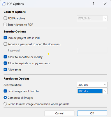

Change image compression from lossless will make for much smaller files.
Settings I use below:
Regards,
Scott

We had tried compressing images a year or two ago and the result was that the surfaces became repeating patterns of unrecognisable psychedelic art. Just tried it again: Pdf size reduced from 35MB to 33MB, and still very time consuming to open - and totally useless to send to our clients. I'm still waiting for it to open in Preview (on Mac): I'll update to let you know if image readability is compromised, although the very modest file size reduction means it remains a severe bottleneck.
Edit: "Imagery" has not been corrupted, but sadly the core issue is unresolved.
