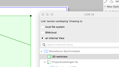

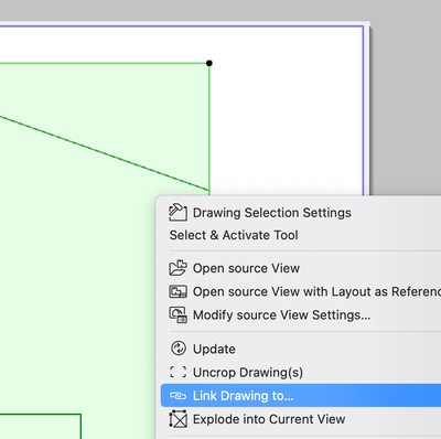

Since the update to 27.2 there's a terrible bug when you want to relink a drawing on a layout or in the drawing manager. It no longer starts on the view you selected but goes straight to the top of the list. That's very unhandy, because normally I just want move just one view up or down like when relinking to another story. Is this bug a known issue and will it be fixed soon in an hotfix? (please).
The behavior before:
The behavior now after the update:

The link to dialogue not pre-highlighting the currently set view, will be fixed in the next hotfix, AC27.2.1

Hi Martijn-MAD,
Have you found any answers for this issue?
I have just noticed it and it is quite annoying.
I use "link drawing to..." quite a lot to relink views up and down as you said and also exiting / demolition / new, Option 1 / 2, etc.

I also expierenced this issue when relinking drawings. AC27 INT 5002, quite annoying one. Search function helped a lot.

And this is also worsen the effect of the property tab always being expanded as it means more scrolling if search isn't used. The ability to relink by drag and drop from the navigator would negate both issues.
