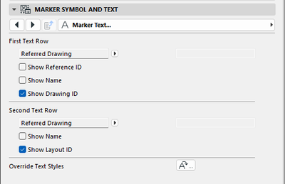

trying to change the 1/A-302 text? can't seem to find this setting but both have been saved as views on layout SD12. if i go to SD12 both sections are correctly referencing the section layout in project map and view map.

Check section Marker symbol text settings, where you can change what is included in the second text row. Also marker refererence source can vary.

the marker symbol text interface was good but did go back to your link and found the solution. basically 2 options 1) the selected drawing or 2) first place drawing of selected view. it was an old layout i created and for some reason it retained the A-302 designation in my initial post v. the new layout designation SD12.
Thank you Ricardo Lopez!!!!
