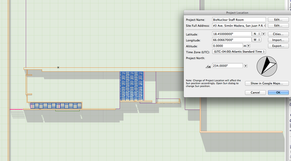

Type of shadow is controlled by 3D Doc settings as shown by Barry.
To change sun position for 3D floor plans you need to edit the Location setting for the project and then update the 3D Floor Plan Doc by selecting "redefine"

Eduardo Rolon
after changing and redefining
Yes but notice in my screenshot I can change the shadow fill type and pen colours.
For some reason in Patrick's EDU version he can't.
In perspective/axonometric then you can also change the sun position in the '3D projection settings' but you must redefine your 3D document.
Not sure if this will affect the 3D doc from plan - don't have Archicad to test at the moment.
Yes it does.
Eduardo Rolon
About the missing shadow settings I just saw the problem and it does not look like a bug.
When you create a New 3D Doc from a Perspective you can turn shadows on but the setting items are not available until you change either "Cut or Uncut Elements" item to any other option that is not "Own Surface Colors/Shaded"
