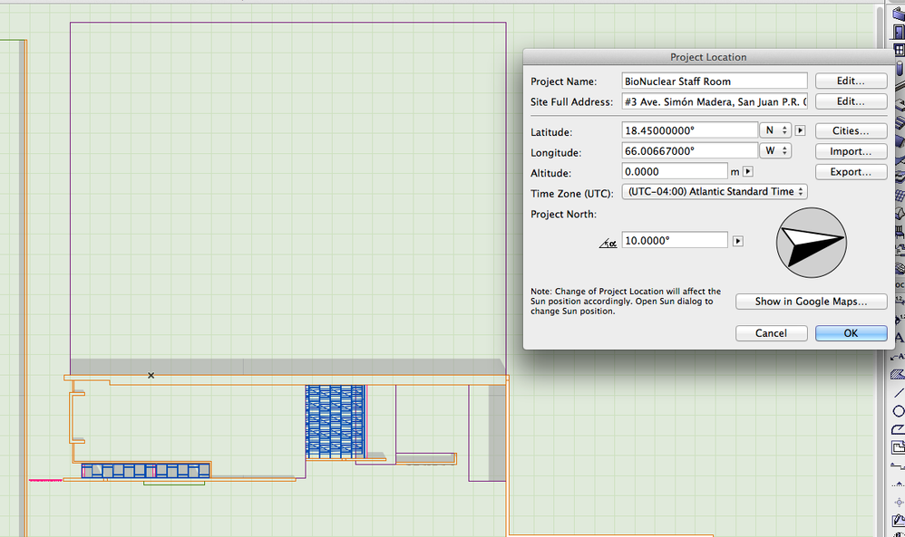

Type of shadow is controlled by 3D Doc settings as shown by Barry.
To change sun position for 3D floor plans you need to edit the Location setting for the project and then update the 3D Floor Plan Doc by selecting "redefine"

Eduardo Rolon
after changing and redefining

Eduardo Rolon
About the missing shadow settings I just saw the problem and it does not look like a bug.
When you create a New 3D Doc from a Perspective you can turn shadows on but the setting items are not available until you change either "Cut or Uncut Elements" item to any other option that is not "Own Surface Colors/Shaded"
