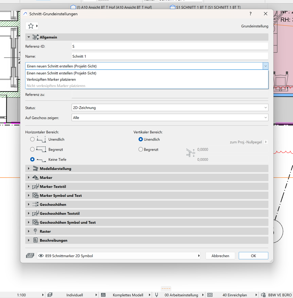

in our Teamwork files the Unlinked Section Marker is not selectable.
Both by placing a new marker or changing an existing marker.
It is grayed out, but only the Section Marker,
Unlinked Elevation Marker works.
In a single pln everything works.
Thanks!

you are talking about this drop down in the section marker settings? or do you mean you cant select the markers that are unlinked?
There are not any bimcloud permissions this specific, so I don't know what would be preventing you from setting a marker to unlinked. Is it office wide, or just for one or two users? A screenshot of what you are seeing may help, but I can't picture what would prevent this... nothing in the work environment or tool settings should. Maybe its a custom marker or something that is scripted to not allow an unlinked marker?
DOWA
Yes, in this dropdown menu it is always grayed out.
In every teamwork file in the office.
Do I have to reserve something extra in Teamwork to access this "unlinked marker"?
This occurs by placing a new one too, and a normal Section marker can be place without an problem without reserving anything extra.

DOWA
Ok, it was a custom marker, maybe from survey models which looks completely the same as the original archicad marker (every option is the same).
Copying an original one from a new pln, solves the problem.
