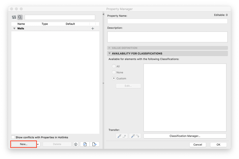

4. Go to Options > Property Manager... to open the Property Manager dialogue box.

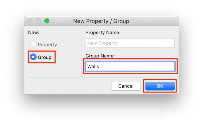

5. Click the New button to the New Property / Group dialogue box.
6. In the New Property / Group dialogue box, select Group, enter the Group Name and click OK.

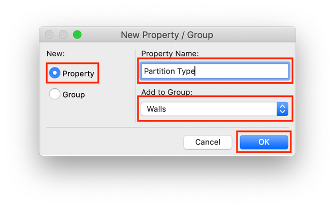

7. Click the New button again to open the New Property / Group dialogue box.
8. In the New Property / Group dialogue box, select Property, enter the Property Name, set Add to Group to the group that was just created and click OK.

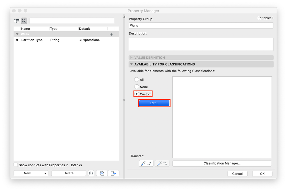

9. Select the newly created group, under the Availability for Classifications tab select Custom and click Edit...

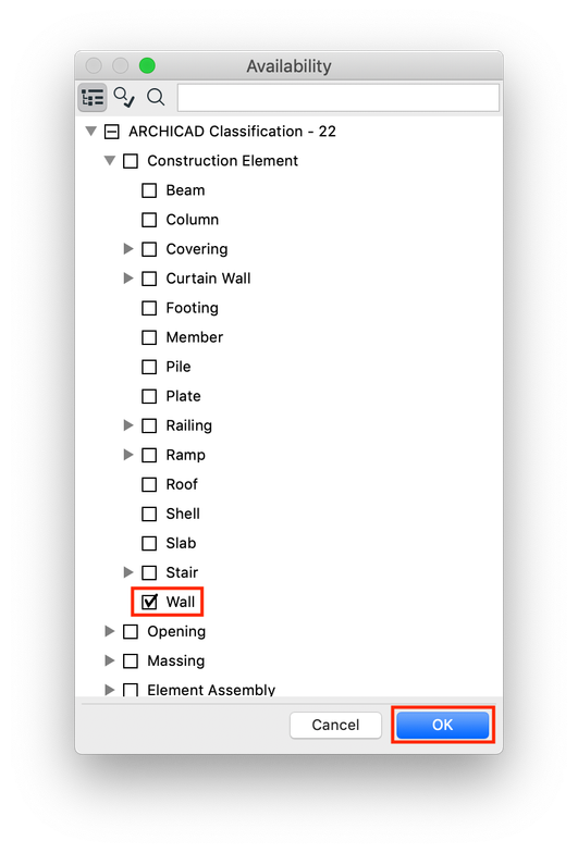

10. In the Availability dialogue box select Wall and click OK.
Note: This will allow the property being created to be assigned to walls within the project. If a different classification system exists in the file, choose the classification that is used for walls.

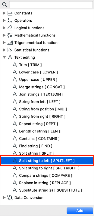

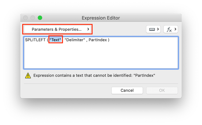

12. In the Expression Editor dialogue box, click the Operators & Functions button.
13. In the pull down menu, select Split string to left [ SPLITLEFT ] and click Add.
Note: This function will allow the user to discard all information to right of the trimming character. If the wall partition abbreviation was at the end of the name then SPLITRIGHT would be used.

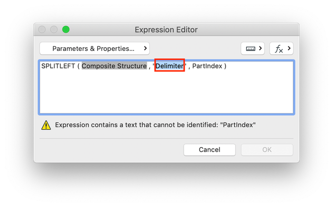

14. The function will appear in the Expression Editor.
Note: The function contains three components. "Text" is the text data that will be split. In this example that is the composite name. The "Delimiter" is the character in the text that will be used to designate where the split will occur. In the example that will be the "|" in composite name. The PartIndex is an integer that designates which part to keep. With this example, 1 will be entered to keep the first part.
15. Select "Text" (including the quotation marks) and click the Parameters & Properties... button.
16. In the pulldown menu, under the General Parameters tab, select Composite Structure and click Add.

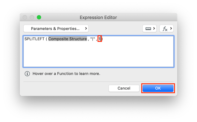

17. Select and delete Delimiter (DO NOT include the quotation marks) and enter the trimming character "|".
18. Select and delete PartIndex, enter "1" and click OK.

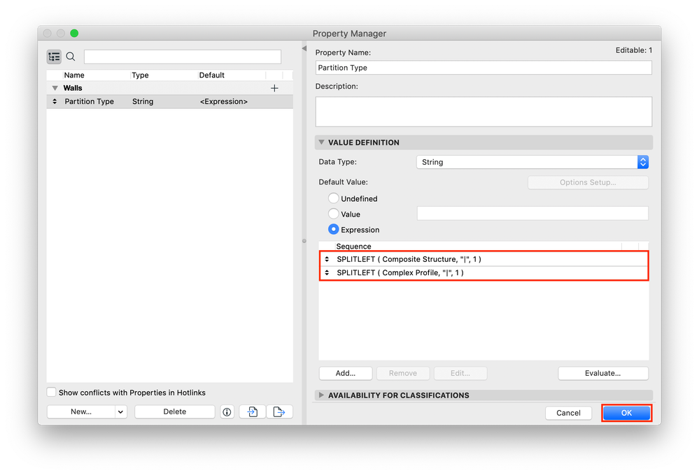

27. The expressions for composites and complex profiles will be listed. Click OK to save changes and exit the Property Manager.

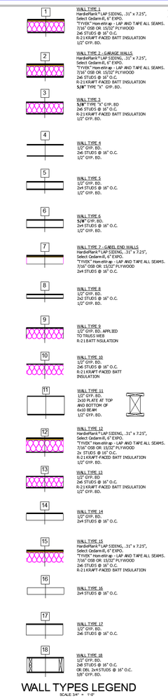

In my little world, the Wall Tag is a reference symbol/Label that corresponds to the Wall Types Legend, which also describes the components/Skins of the Wall, displayed by another Label, perhaps some dimensions.... For example, something like this:
Wall Tags don't require any Expressions, you can do it with the basic Labels provided in the program.  https://www.youtube.com/watch?v=YJYUc0vpQyw
However, I do appreciate the example for how to create and Expression.  Very good.  Thanks.
