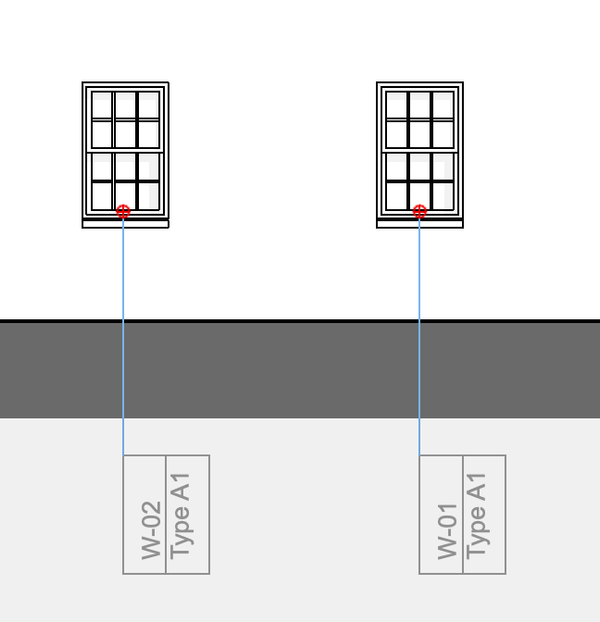

For instance when I create an elevation and place this on a sheet it all looks fine. Ive created labels specific to window types.

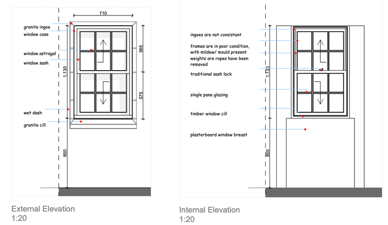

Ive then been creating 'details' to draw each window at 1:20 to schedule out specifics for each window. Ive been using 'detail' tool to do this by making each 'detail' a 'drawing'. This has been slow as each time ive had to adjust the window, ive had to decide if to refresh the view, then spend time deleting or adjusting the lines/ hatches or other elements. Ive also found dimensions don't seem to link to anything specific, so if I adjust a line, the dimension does not link to that line. This is very similar to how AutoCAD worked. In Revit the dimension is linked to the line regardless.
Id also like to create a part elevation of 'groups of windows' and thought duplicating the view would allow me to do that.
I then went to adjust the labels, however ive found this then also adjusts the labels in the main 1-100 scale elevation. Do I need to create a new elevation for each specific view from within the project map.
