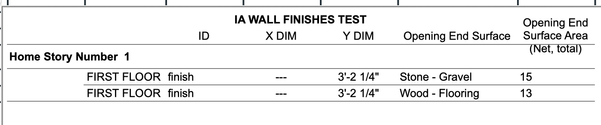

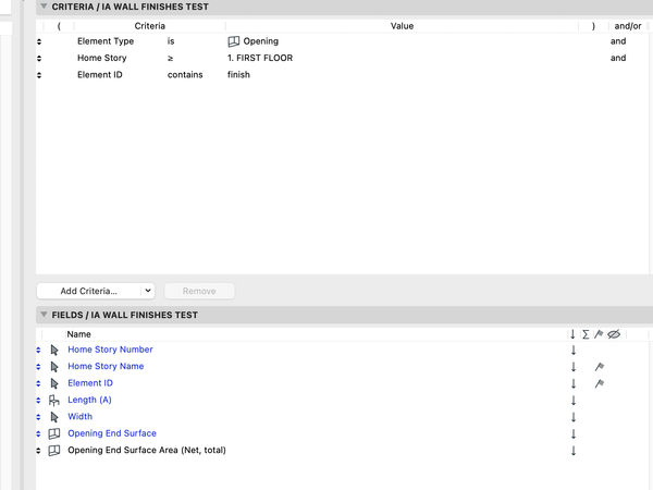

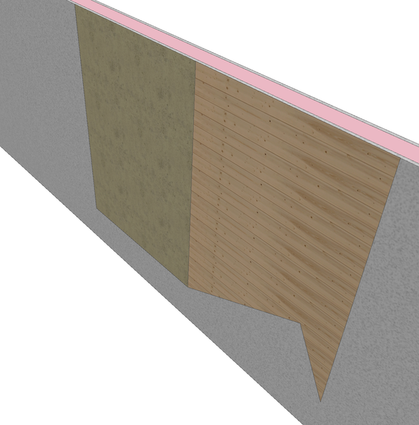

Late night, untested idea except for the following: minimal thickness (in sketch, 1/64" deep) Openings, which will not interfere with dimensions to core or face of wall, can be used to produce any design on the wall surface, and their area calculated. “ID contains” criteria, and systematic IDs, can help in scheduling setup too. And they can be on some specific Design Option shown only on certain 3D views and schedules.

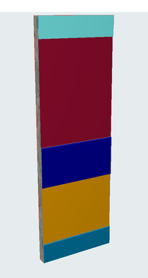

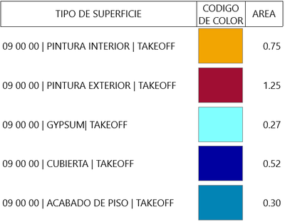

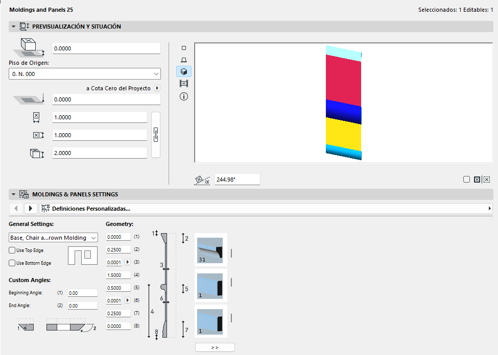

Hi, For these types of situations, and in relation to multiple finishes on the same wall section, I sometimes use the wall accessory that comes in the Goodies package. I assign defined surfaces to the areas I want to calculate and use an exposed surface area Schedule. I also adjust the exposed surface calculation rules by adding objects elements and linking them to a specific ID in case it's necessary to discard finishes from the walls hosting the accessory. It has its limitations, but it's very useful for walls with linear finishes. If the wall size changes, the accessory updates automatically. A wall can have an accessory on each face, and I can assign an ID to each one to identify them.
I hope this helps.
