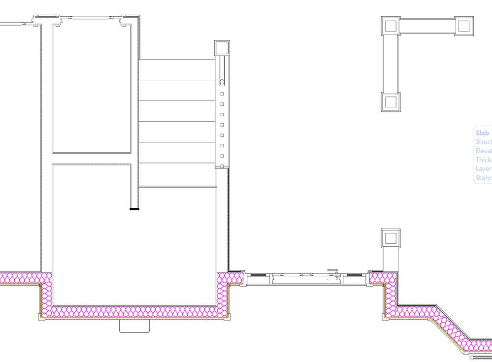

assistance w/ SEO wall displaying on floor plan?
proto
In plan, I'm expecting to see the wall as solid below 4' & dashed above that datum.
However, it doesn't seem to be doing that...what should I look at to rectify this?
I've rebuilt it several times & I get the same thing. I'm guessing there's a setting I'm missing?
I'm able to delete the linework in the partial plan enlargement, but the plan from which it comes is still "wrong."
Any thoughts on what to look at to resolve this condition?
Thanks up front!

it works just as expected.  You can adjust and change that kind of opening in a section, elevation, 3d view... just mode the nodes of the opening to where you want them.  https://www.youtube.com/watch?v=YbNA8G8vBUU
19 REPLIES 19
Walls do not display differently in 2d from solid elements. You will see the difference you're talking about but only if the overall wall height falls above or below the cut plane distance.
Hi Proto, I think you should change your show projection setting for the wall selected from Entire element to Floor plan range.

That's what's weird. I think I have my cut plane at 4' above the ground. Ceiling is at 8'-6" for reference.
Below is my Floor Plan Cut Plane dialog

Try to make Relative floor plan range - Show up to Current story and put 4’.

It may also take a 3D view for us to know for sure what your wanting to do.  Keep in mind that the Floor Plan view is not and exact Cut Plane View because sometimes it is more useful and efficient to make some exceptions to the rules for the sake of clarity.   What I thing you are wanting to do is to show walls correctly on a Floor Plan that are similar to something like this -  2021-10-04_14-21-01.png  you can make a truly accurate view of it ( if that is what you really want) with the help of a 3D Cutaway and a 3D Document.  But you may also be able to get what you need from a wall or a beam.   Here is an example of a wall and a beam of the same dimension in Plan view that can be made to look the same - and that are accurate at the Floor Plan Cut Plane.   2021-10-04_14-58-53.jpg

Here's a 3d view
Just a basement stair that will have storage beneath the stair.
I want the wall to show in plan view that it rises above the cut plane w/ dashed lines...whether that is in concert with how the stair does this is less important...gotta walk before i can run
it shows in 3d & in section, but not in plan yet
