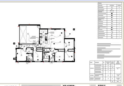

i already have an electrical plan with legends schedules.
what im tying to do is to provide a (different option) as an upgrade pack with different lights and different number of power points and so on... and add this to the existing master plan.
what is the best option to do that in the same drawing without the need to create different layer combination and different scheduling etc... is there an option where i can add a view map drawing into the criteria of the schedule ?

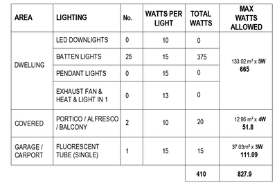

while we are on the same topic any advise on how to automate the calculation of the wattage ?
please see snippets below.
thats what i have as standard. the upgrade pack will be in the same master plan but not included in the publishing set if not selected.
