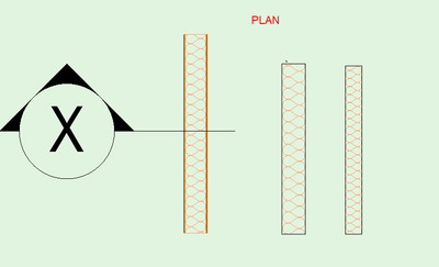

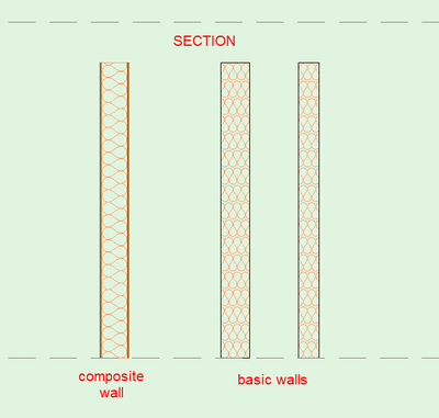

how to rotate fill pattern in section?
kimaa
The Fill Pattern of Insulation - Mineral Soft works great on Floor Plan view.
But It does not fit to skin in Section View.
How can I fix it? 

I suppose that you should be using a composite wall, even if it's made of just one layer. Otherwise you cant use the Fit to Skin option in the building material settings.
ArchiCAD 27 GER / Win10
Solution
As Xandros mentioned, it seems it needs to be  a composite or complex profile wall for the fit to skin to work in section.

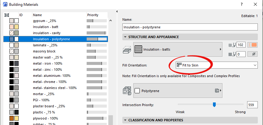

Make sure your insulation building material has the fill orientations set to 'Fit to Skin'.

my fill orientation is already set to 'Fit to Skin'.
'Fit to Skin' option works good on Floor Plan. but, not on Section view.
Solution
