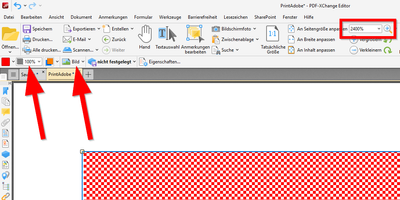

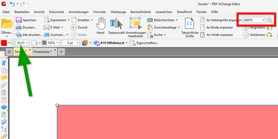

Fills with transparency are approximated with small 8x8 bitmaps - the real bitmaps; each pixel is '0' or '1' for transparent or opaque.
And you need a whole lot of these bitmaps for larger areas, wich leads to larger files.
Some screenshots, fill with 50%, bg pen 0; SavedAs and printed with Adobe:
SaveAs produces an object with trancparency, you could alter the opacity (and color).
Print produces a 100% opaque picture ('Bild') consisting of a pixel grid, every 2nd is transparent > 50%.
