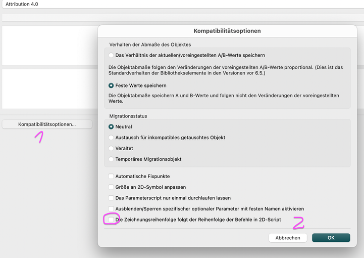

The drawing order kind of depends on the order of the commands – but only kind of. There are still some internal rules that should be drawn upon what.
But! If you do not want to use draw index you can force the order with this button in the compatibility options: (sorry for German screenshot)

That did it, thank you! I figured there was some setting I was missing.
