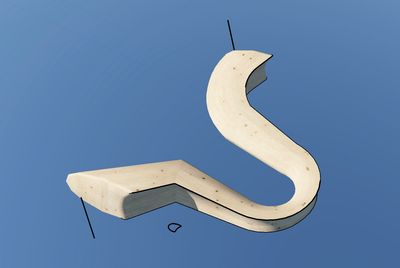

I want to extract the shape of a profile for a next further possibility to edit it in the objects....It is our ArchiRADAR problem to make everything complex for us in the code but simple for the users!!:-)
yesterday
- last edited
yesterday
by
Here my 2 ct.:
I request it in Masterscript this way - so its adressable from 2D and 3D-script later over renaming "myProfileIdx" before jumping to this function:

Then - in 2D or here in 3D, i "make something" out of its data:
! 4. HANDLAUF-SEGMENT (Zieht das Randlaufprofil)
if isOuter = 1 then
myProfileIdx = Randlaufprofil
gosub "Profil übernehmen"
hl_versatz = -0.015
if n then
for _iComp = 1 to _nComponents
if _bShowPart[_iComp] then
dim _currSurfaces[]
n = REQUEST{3} ("Profile_component_info", myProfileIdx, _iComp, "gs_profile_comp_surfaces", _currSurfaces)
_bmat = 1 : _surface = 1 : _pen = 1
n = REQUEST{3} ("Profile_component_info", myProfileIdx, _iComp, "gs_profile_bmat", _bmat)
n = REQUEST{3} ("Profile_component_info", myProfileIdx, _iComp, "gs_profile_surface", _surface)
n = REQUEST{3} ("Profile_component_info", myProfileIdx, _iComp, "gs_profile_outlinepen", _pen)
building_material _bmat : pen _pen
_routePts = 4
put (_contEndPoints[_iComp] - _contStartPoints[_iComp] + 1) / 5, _routePts, 1 + 2 + 16 + 32
_surfIdx = 1
for _i = _contStartPoints[_iComp] to _contEndPoints[_iComp] step 5
put _profileGeometryRawData[_i] - hl_versatz, _profileGeometryRawData[_i + 1], _profileGeometryRawData[_i + 2] + _profileGeometryRawData[_i + 3] + _profileGeometryRawData[_i + 4], _currSurfaces[_surfIdx]
_surfIdx = _surfIdx + 1
next _i
tube_dx = rx2 - rx1 : tube_dy = ry2 - ry1 : tube_dz = rz2 - rz1
put rx1 - tube_dx, ry1 - tube_dy, rz1 + h_gel - tube_dz, 0
put rx1, ry1, rz1 + h_gel, 0
put rx2, ry2, rz2 + h_gel, 0
put rx2 + tube_dx, ry2 + tube_dy, rz2 + h_gel + tube_dz, 0
tube{2} _surface, _surface, _surface, get (NSP)
endif
next _iComp
endif

My example is from here: AC29EduAut - a "stairway" through all needed storeys at once.
