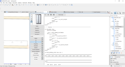

The last line of gdl editor is not displayed.
LeeJaeYoung
When there is no gdl editor
When gdl editor is open
Why does this phenomenon appear?
It's something that happens on laptops...

Ahh, I see.
You mean the buttons for zoom, page orientation, scale, etc.
It could well be your screen resolution if you only have a small screen.
Ideally you want a resolution of 1920 x 1080 with 100% scaling.

You should see a horizontal scroll bar at the bottom of the script window.
If you are on a laptop, it may have something to do with the screen resolution.

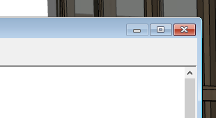

Use the 'restore down' button to un-dock the script window and re-size it as you need.
LeeJaeYoung
RESTORE DOWN BUTTON NOT FOUND.

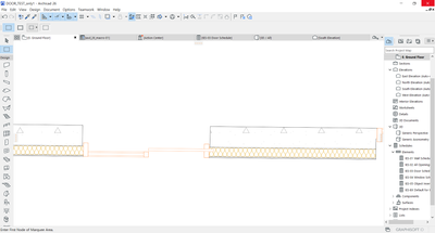

Sorry I forgot to attach an image.
It is the middle button that controls the sizes of you windows.
Make sure you do not click the bigger one above which is for Archicad itself.
In the floor plan, the bottom does not appear until GDL EDITOR is turned off.
AC27 on window 11
This will make the lower part visible in the plan view.
However, if you go back, it is the same that the lower part of the gdl script is not visible.

Is your script window undocked?
thank you
It was set to 125%.^^
