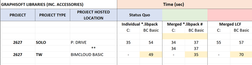

Hi all, thought I'd try a test and share my results (& pain) with anyone still struggling with this.
Here's what I tried: extracted ALL the Graphisoft *.libpacks and compiled them into:
  1. Merged ArchiCAD29 library  *.libpack, and
  2. Merged ArchiCAD Libraries 29 *.LCF file.
  3. First Colum (Status Quo) is the current setup with all the Graphisoft *.libpacks separate
Also tested whether the file being Solo or on Teamwork made a different
And where the Library was hosted: locally (our P: drive) or on BIIMCloud Basic - if I have time will do this on SaaS as well, but I suspect this will have longer load times)
This defeats some of the goals of the global libraries as the Merged LCF and libpack will no longer be able to do the live check (which I suspect may be part of the problem anyway). I also stripped out any mapping and translation files for simplicity
Graphisoft Certified ArchiCAD BIM Manager
ArchiCAD 29
Windows 11
So, if I understand right:
  • If you work on a Solo file, the OOTB individual Lib Packs loaded from your computer's storage device are about as fast as a merged Lib Pack file loaded from your computer or from the BIMcloud Basic server. No reason to create merged Lib Packs for load time reasons.
  • If you work on a Teamwork file and use BIMcloud Basic (on-premise BIMcloud), the merged Lib Pack is the clear winner.
  • The merged LCF is never a good choice.

That's correct @Laszlo Nagy   - so this would make loading BIMCloud libraries for Teamwork Projects simpler
But you'd need to recombine when there's a Global Library update that your firm required.
