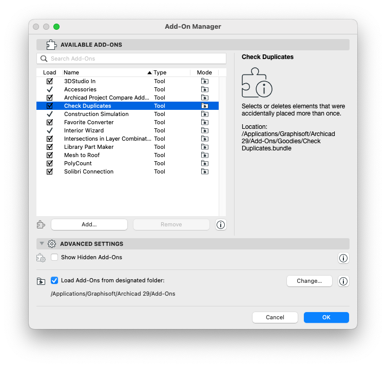

We did install the goodies add-on. We check in the add-on manager if the add-on is loaded and it is. We verified all menu and the tool check duplicates is not there and we did also went to the work environment and it not there.

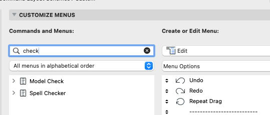

having this exact same issue - it's listed in the Add-On Manager, but it does not show up when selecting "All menus in alphabetical order" in the W/E.. but the commands within the menu do show up (but without the menu menu, so they do not load).

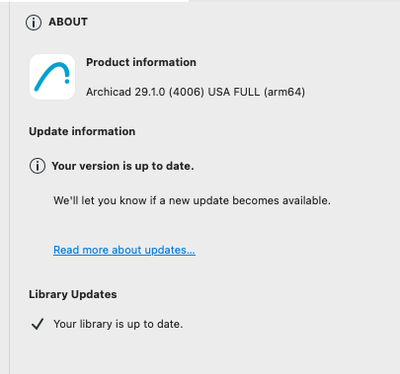

Everything is up to date.
This is a function that is relied on a LOT so this glitch in AC29 needs to be rectified asap.

If you are trying to add the commands to the menus in your Work Environment (I think that is what you are trying to do), then you can't search all menus in alphabetical order, because the commands are not yet in your menus.
You must search all commands in alphabetical order and add them to a menu.
TaniavH
I already tried that - several times. It does not work. This is clearly a bug.

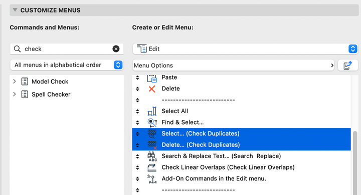

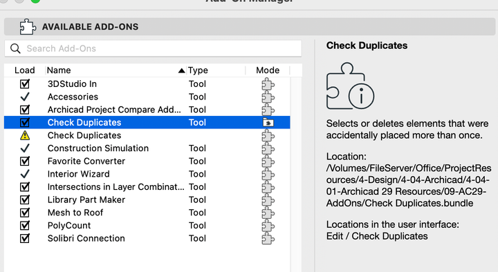

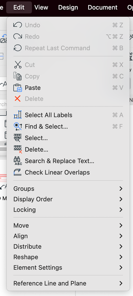

follow up... copied the add-on to a different location on the server, linked it via the add-on manager (i.e. pointed check duplicates to the new location) - and it loaded - by default into in the Options Menu (???) - sigh - then I moved it to the Edit menu in the W/E - this is a crazy workaround but will have to do until GS addresses the issue.
