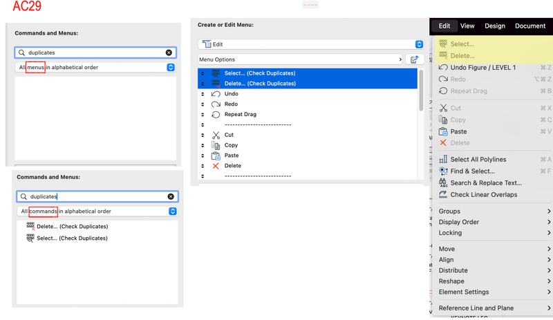

- loading the commands directly got it to work, thanks for the tip Ling!

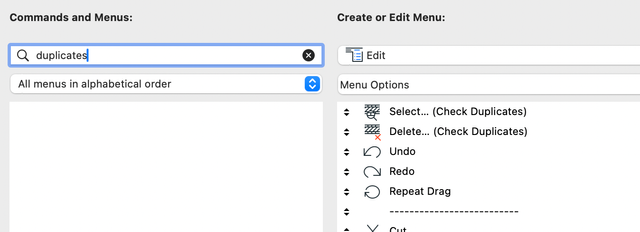

This must be a new thing, previous versions showed the text in brackets and the menu could be found in the W/E search field:
Seems like the menu no longer exists, just the commands...

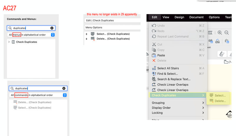

Even with the commands added, the menu is not found in a search...you have to search in the current menu after adding the commands to a toolbar (now I understand what you were trying to say, Barry)...completely unnecessary restructuring as far as I'm concerned...probably has to do with the introduction of menus within toolbars...previous versions you did not need to do this, you could just find the menu from the get-go....
