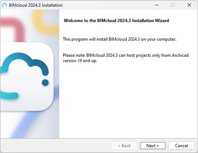

Installation Wizard - start installation 1. Start Installation Wizard Download the latest BIMcloud installer from the BIMcloud download page and run it directly to start the Installation Wizard.
Please Note
Starting with BIMcloud 2018.2, all BIMcloud components can be installed and updated using a single installer package. You can also use this installer package to update previous BIMcloud Basic versions to the latest version.
2. Welcome Screen
  1. Make sure to close all running applications before you proceed with the installation. On Windows Server operating systems, make sure to close Server Manager before continue.
  2. Click Next to continue.
3. BIMcloud Installation Options
  1. Choose Install new BIMcloud or BIMcloud component option.

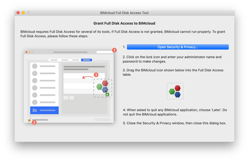

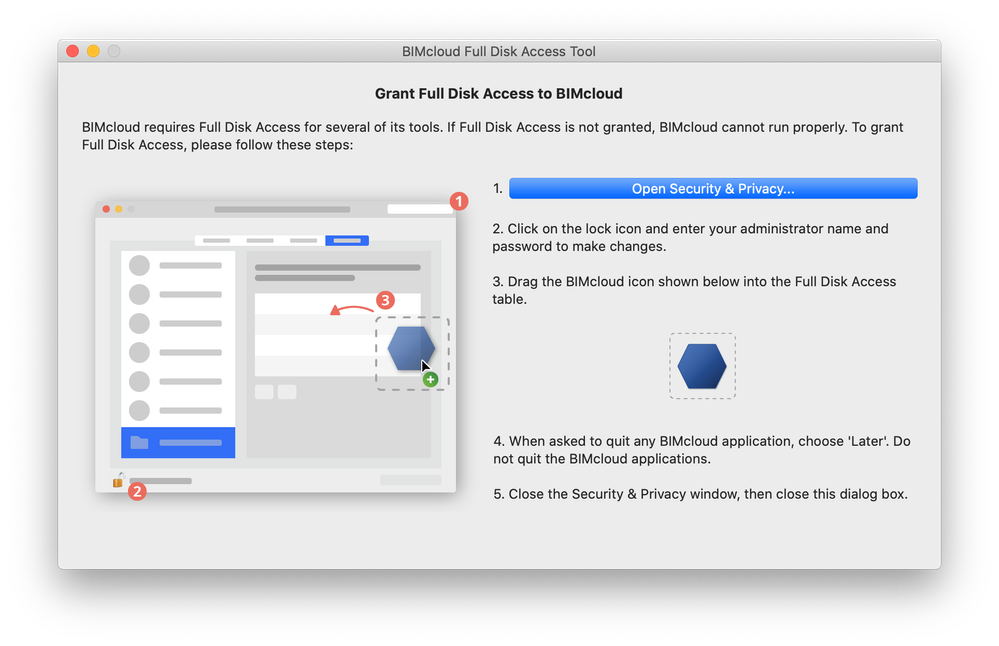

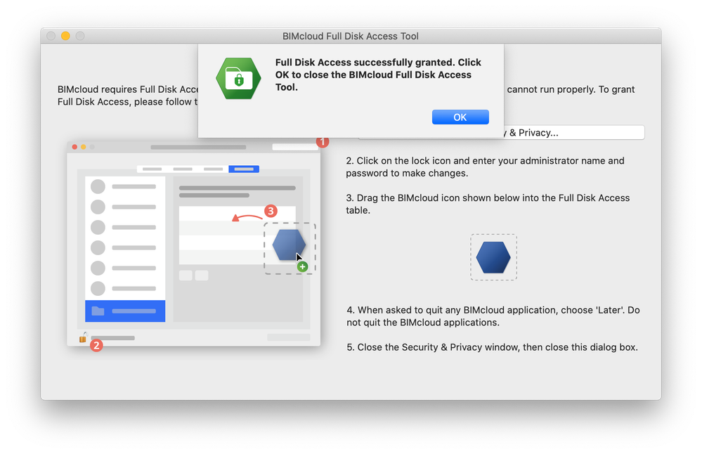

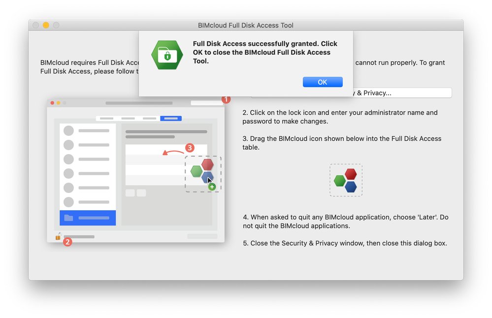

Please Note
If you are installing BIMcloud Basic on macOS, you must grant Full Disk Access for BIMcloud Server. The Full Disk Access Tool appears automatically, to help you grant the necessary permissions.
Full Disk Access Tool for BIMcloud Server
  1. Click the "Open Security & Privacy..." button.
  2. Click the lock icon and enter an administrator name and password to make changes.
  3. In the Security & Privacy… settings page, drag the BIMcloud Server icon into the Full Disk Access table.
You will see a notification that permissions have been granted successfully. Click “OK” to continue installation.

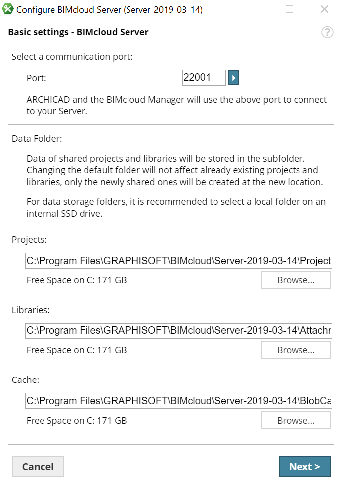

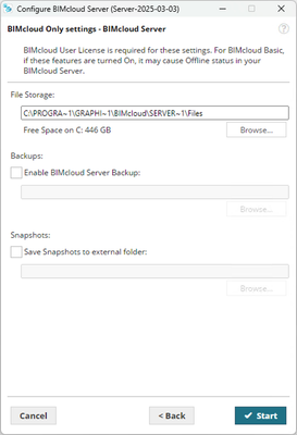

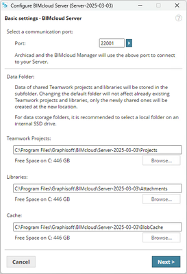

8. Configure BIMcloud Server
  1. Port: Select a free port, or use the "Find an available port" command to automatically find one. See the default port numbers in the Network Requirements.
  2. Projects folder: Enter or Browse the location of the project data folder. This will be the location of Teamwork projects on the BIM Server. If you have other BIM Server version(s) installed, make sure to choose a different folder for the project data!
  3. Libraries folder: Enter or Browse the location of the library data folder. This will be the location of Teamwork libraries on the BIM Server. If you have other BIM Server version(s) installed, make sure to choose a different folder for the library data!
  4. Cache folder (from v20): Enter or Browse the location of the Cached data folder. This folder stores cache files from projects and libraries which are actively used. Note that the size of this folder can be really large based on the actively used projects and libraries.

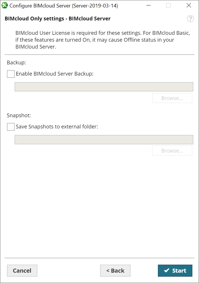

  5. BIMcloud Only settings: Leave these settings empty. These features are available only for licensed BIMcloud users. For more information about the extra features, see our website.

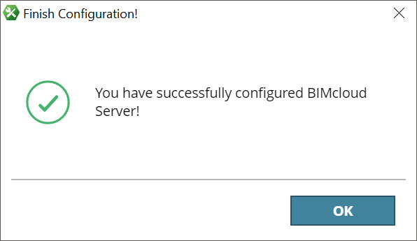

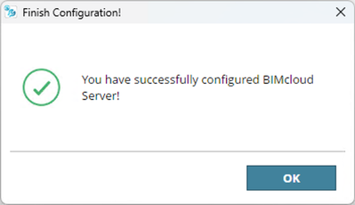

  6. Click Start.
  7. Finish Configuration dialog will pop up, reporting a successful configuration. Click OK to continue.

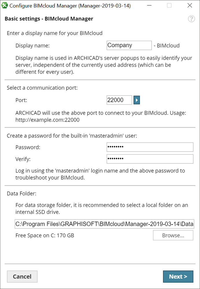

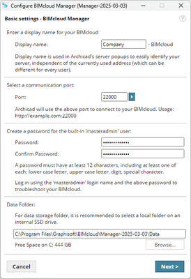

15. Configure BIMcloud Manager
  1. Display name: All server pop-ups will identify BIMcloud Basic by this name, by default BIMcloud Basic will use the name of your computer.
  2. Port: Select a free port, or use the "Find an available port" command to automatically find one. See the default port numbers in the Network Requirements.
  3. Master administrator password: Create a secure password for the Master Administrator (username: masteradmin) user. This user will always be able to log in to BIMcloud Manager with full access. The masteradmin user is created for maintenance and troubleshooting purposes.
  4. Data folder: This is the BIMcloud Manager's data storage folder. Note that project and library data are stored in a different folder, configured at BIMcloud Server settings.

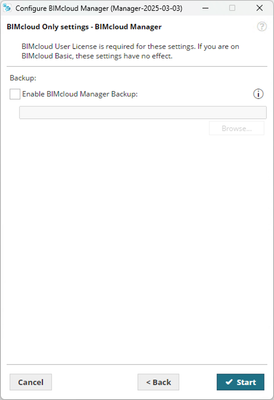

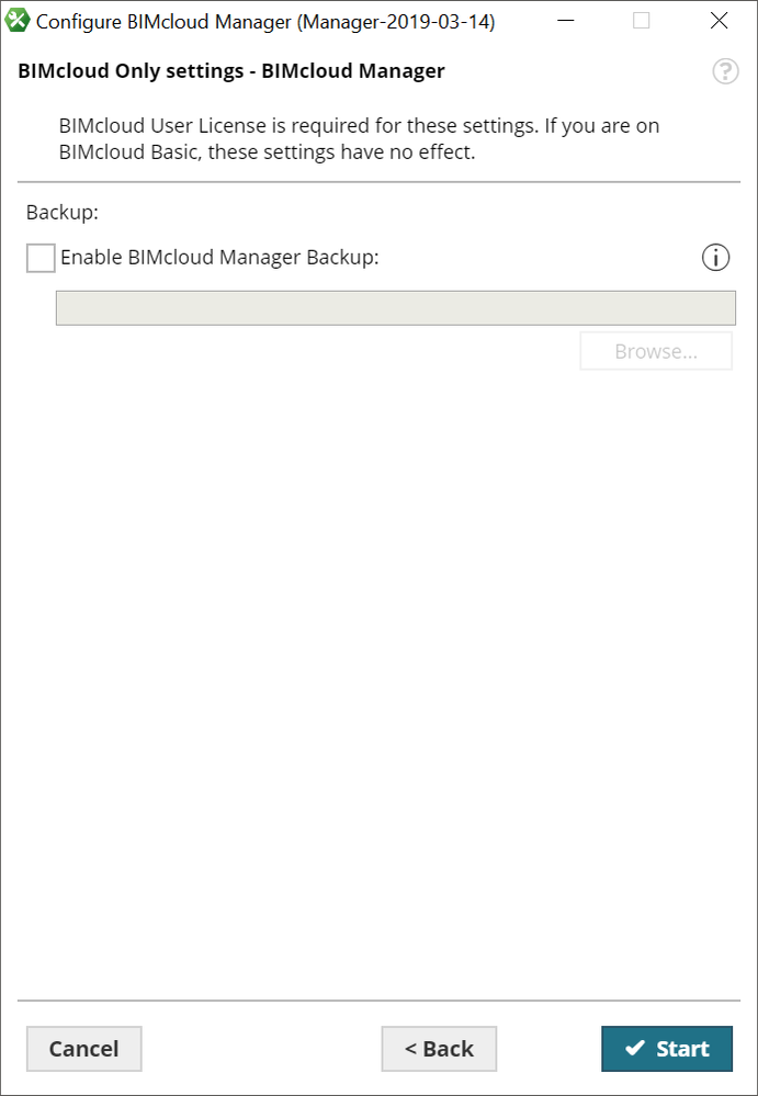

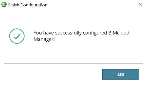

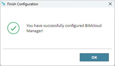

  6. Click Start.
  7. Finish Configuration dialog will pop up, reporting a successful configuration. Click OK to continue. This will automatically open a browser window.

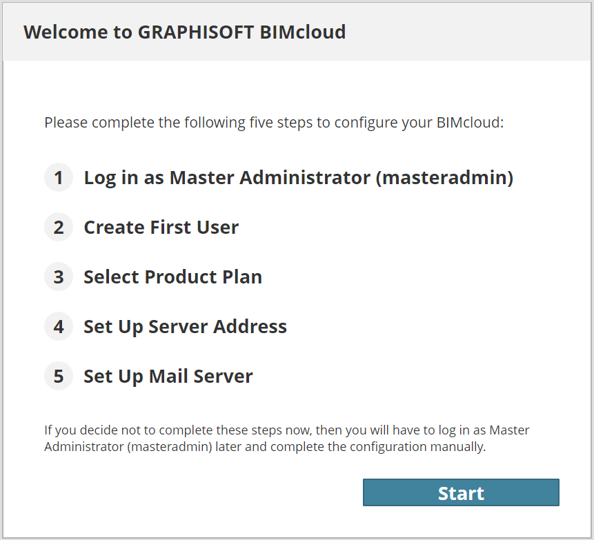

Finalize configuration 16. Continue the Configuration in a Browser
  1. Click Start to continue.

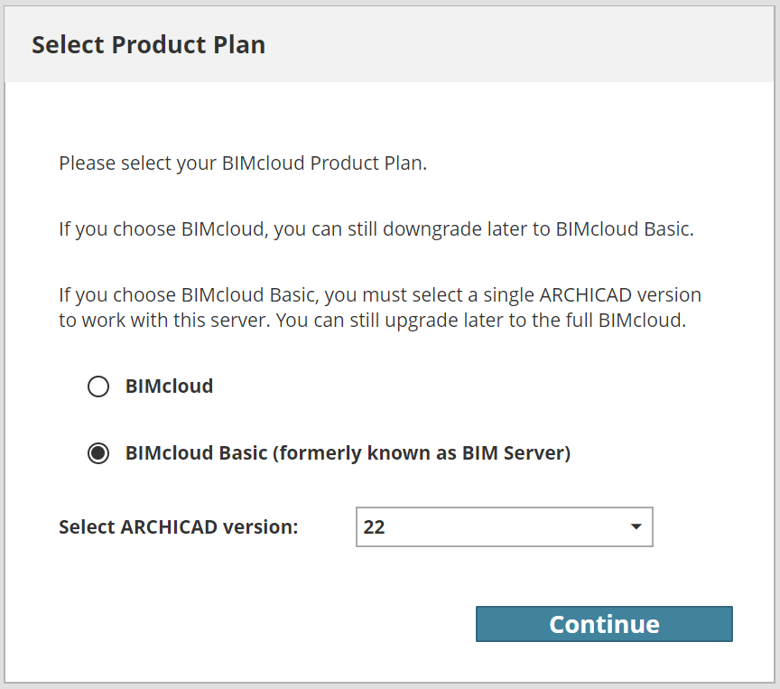

20. Select Product Plan
  1. Select BIMcloud Basic (formerly known as BIM Server). You can still upgrade to the full BIMcloud later if you wish.
  2. Select Archicad version: You will be able to connect to BIMcloud Basic using this version of Archicad.

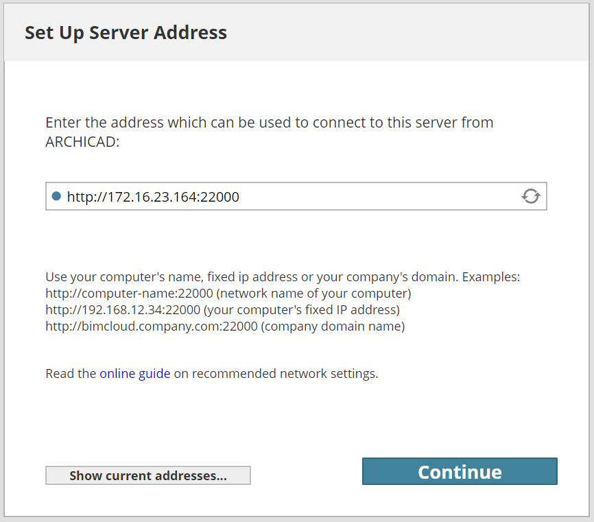

21. Set up server address
  1. Enter the address of the computer where BIMcloud Basic is installed with the Manager's port number. This address will be the primary address of the BIMcloud Basic. It is recommended to use a fixed IP address, a computer name or a fully qualified domain name. Use the Show current addresses for hints or see the Network Requirements for further information about the possibilities. The address can be changed later on the BIMcloud Manager's Settings panel.
  2. Click Continue.

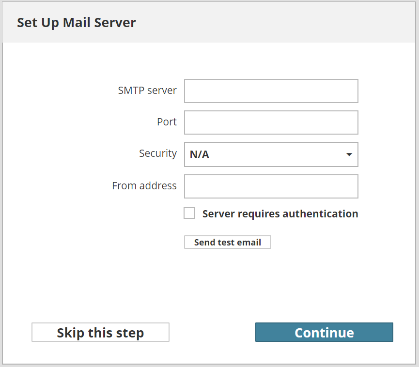

22. Set up mail server (optional)
  1. Using a mail server is optional. However, if you do not define a mail server here, you will not be able to send emails (e.g. password reminders) to users from BIMcloud Basic. The mail server settings can be modified or set up later in the BIMcloud Manager's user interface. Click Skip this step if you want to set up later.
  2. Click Continue to finalize the configuration.

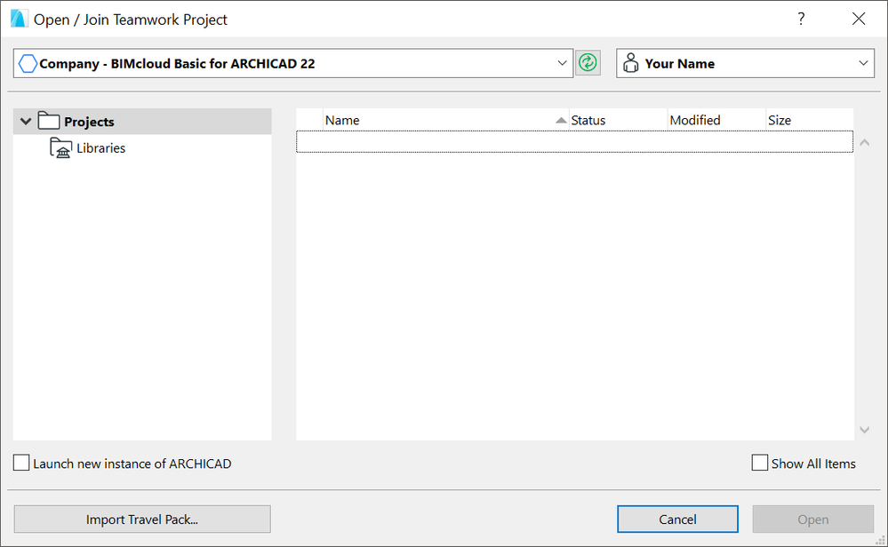

2. Test Teamwork
  1. Run Archicad on a client computer.
  2. Create a New Project.
  3. Select Teamwork > Project > Share... from the menu.

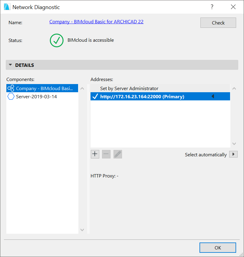

  4. Enter the BIMcloud Basic's address and the previously created user's data in the Log in to BIMcloud dialog then click on the Run Network Diagnostic to check the connection.
  5. Open the Details panel and select all components one by one from the Components list. Verify that all components are properly accessible. If you experience any issues, please follow the troubleshooting process.
  6. Click OK to close the Network Diagnostic dialog.
  7. Click Log in.
  8. Click Share in the Share Teamwork Project dialog.
  9. Wait while Archicad is sharing the project.
