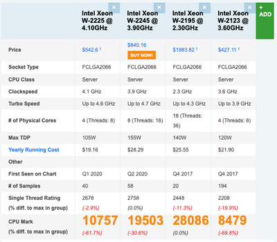

Agreed with SenecaD with this. W-2245 is a better fit for Archicad in pretty much every aspect. It seems better with single core, and with multi core too, a lot better. At least according to Passmark software suit tests. Please see pic attached.
I just updated one of my HP Z4 G4 to a W-2195 (added that in the comparison too). It's not nearly in the ballpark of the latest and greatest CPUs out there, but I'm quite happy of the boost from W-2123 four core (in the pic too); with renders, and with background updates of the AC tabs.
AC28, Rhino8+Grasshopper, TwinMotionMac Pro 6,1 E5-1650v2-3,5GHz/128GB/eGPU:6800XT/11.6.5 • HP Z4/Xeon W-2195/256GB/RTX4080FE 16GB/W11ProWS
