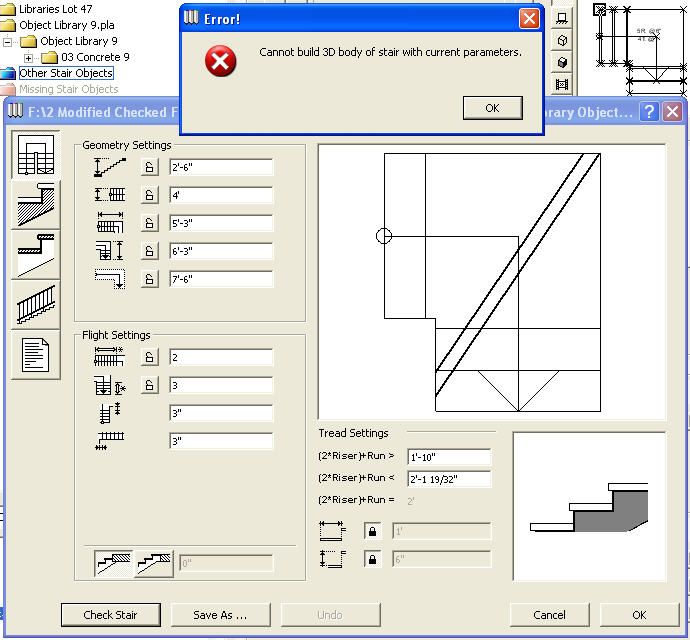

I'm having trouble with the attached stair, and I don't know why. I would sincerely appreciate it if someone could please tell me what I'm missing? The stair returns an error message with solid risers, but OK with open risers. Nothing else changes. Thanks.

Just a guess: try to move the riser a bit further away for the innen corner where the stair turns.
Maybe one of them is too close which causes StairMaker not to be able to generate the 3D body.

Thanks Laszlo, I had tried that a few times using different dimensions without luck. Also, why would the stair properly build with the open riser selection, and not with the solid riser selection when no other parameters are changed? Thanks again.

Graphisoft wrote:
R&D has acknowledged this as a bug and added it to their bug database.
