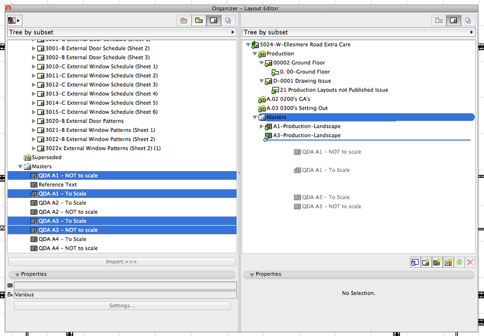

I have "reserved all" in both projects, opened Organizer in the project I want to transfer the masters into, working in layout tabs for both projects. I drag and drop the desired masters into the new list (a plus symbol and blue line appear indicating that it should work), then nothing. Nothing happens. No warning, or error, or crash, just nothing.
Any ideas? Is there a way around this? I also can't seem to find the ability to export the masters and re-import them manually (without Organizer).

Keito64,
I have no TW Projects running so could you check something here?
Can you reserve the Masters item in the Layout Book in the right pane? Maybe that is what is needed for you to be able to create new Master Layouts by drag-and-drop.
I suppose the you have the proper Access Rights as a TW User.
Otherwise the drag-and-drop should work with TW projects as well so if it doesn't I will report it to GS.

Hi Laszlow,
I believe it is reserved (even if the green dot does not appear so - screenshots 1. & 2. attached). I have restarted ArchiCAD, and my computer, and just tested again with no luck.
I have both projects open and with everything reserved, I am also the only person online at the time and the reservation dialogue shows no conflicts.
There was an interesting thing, however. If I select a master in the right pane, and then select a master in the left pane, the 'import' button becomes available, and when clicked, a dialogue says not much and hangs for a while before disappearing (screenshot also attached 3. & 4.).
I just can't tell if I'm not doing something right or if it is a GS issue.

OK, I will report this to GS.

Has anything developed on this issue? Trying to import Master Layouts from AC 18 to 19, I am having the same problems--and not using TW. Drag and drop does not work, nor does import. Never had the problem with previous version upgrades.

Well, I'm waffling between more annoyed and less. As it turns out, both the drag-and-drops AND the imports worked. However, neither showed the imported layouts in the AC 19 Organizer. I left the computer, came back some time later, and there they were--multiplied by three, matching the number of attempts I made.
