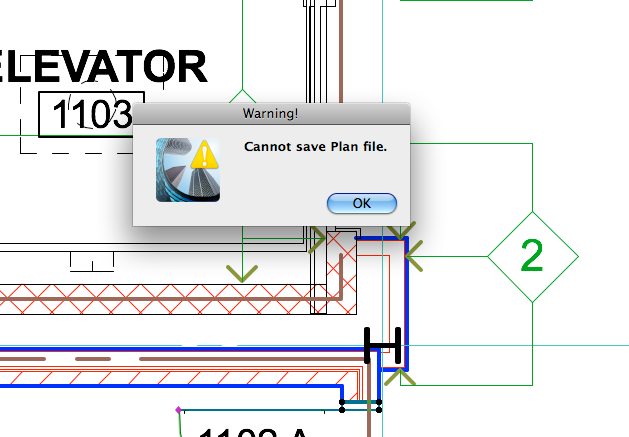

For some reason I occasionally get this error while saving.
Cannot save Plan file.
It strange because sometimes I can save and then sometimes I can't.

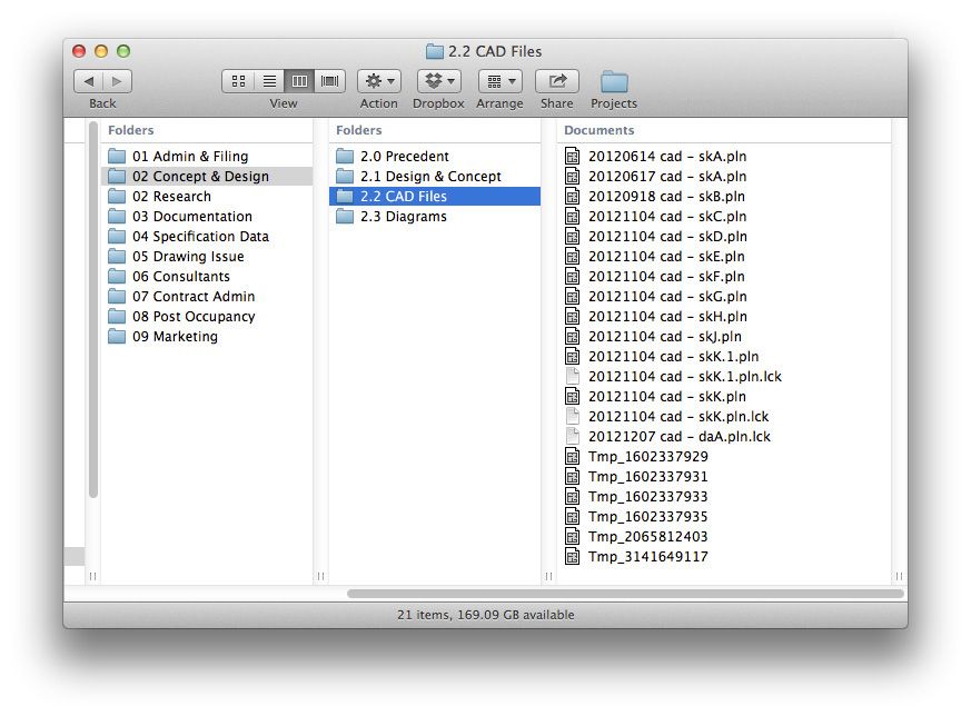

I have been having this problem for several weeks running Archicad 15 on Mac Os 10.7 and then 10.8. I can not see a pattern as to when the file save error occurs.
However, there does seam to be some associated problems (refer to the attached screenshot), ie:
- multiple temporary files
- locked files (even though the files are not open and AC was closed correctly)
Sometimes the file disappears altogether making me think it might be an OS problem? This usually resolves after a restart.

Dear Talkers,
There are two different issues what we know of and can cause the save error:
1. If the problem is present on the local computer the issue is most likely due to some sort of permission problem. This is possible even if the user has Administrator rights on the machine. We have information about many cases when users changed their Work Environment from one OSX system to another and used one of the following tools:
- Time machine back up
- Migrating Assistant
So if there is any chance that you used one of these tools that could change something in your user account permissions and cause this error even though you seem to have Administrator rights.
To check if this is the issue try the following:
- Move a file to your desktop, open it from there and see if the saving error still happens
- If so, try to create a new user account on your machine, that should solve the issue
2. When saving is not working on a Windows server from a MAC machine try to do the following:
- close all Finder windows
- try to save anywhere else but to the desktop of the server
If you can save this way then it is a known bug. We think this is not ArchiCAD's fault but it is not present with other software. We think it's more like an issue with the interaction between the Apple OS and the Windows Server. Unfortunately as long as we can't reproduce this issue in house we are unable to report it to Apple or Microsoft.

I was having the same problem about not being able to Save on the Windows server shared directory. I could "Save As" but I was not allowed to simply Save.
It was in fact a permissions error, and once I changed the sharing permissions on the server my problems went away.
I can't remember what exactly it was but I think that the server was granting me read and write access but I didn't have "full control".
So go over to your Windows server and make sure that you are allowing all the permissions for the directory that you are having problems with.
