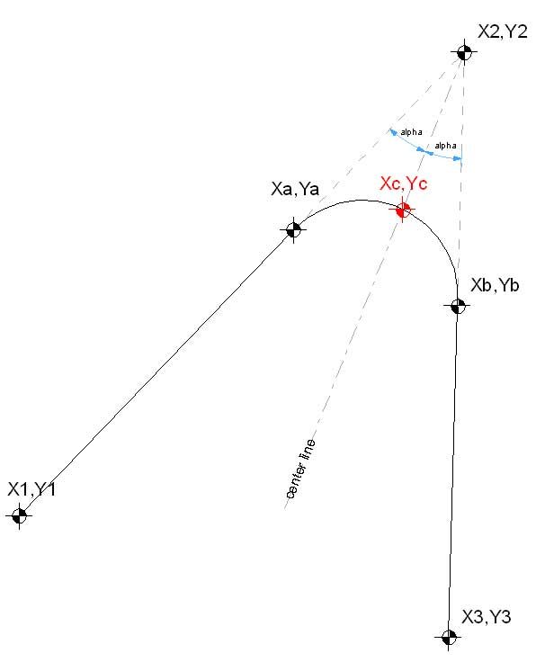

I just do not know how to tackle this problem and/or if it is solvable with given variables. Basically I would like to calculate the coordinates of the tangential fillet center of two segments.
if someone could help I would appreciate
ta
X1,Y1,X2,Y2,X3,Y3 - known
Xa,Ya,Xb,Yb - known
Xc,Yc - ???

You should be able to calculate it by pythagoras and TAN. I have added some length (L,r), which are known out of your settings

I appologise, I have forgotten to mention that alpha is not known, it's there just to demonstrate the centerline of the angle.

Are you shure that the both distances L are identical? Elsewhere the center line and alpha is not the only problem. 😉

yep, the L distances are identical

I think if you know the coordinates of all three corners of the triangle, you should be able to find out any of the angles of the triangle. Alpha will be half of the angle at point 2.

thanks laszlo for your suggeston, it did not solve the problem, however it gave me the starting idea and finally solution after couple hours of sketching and calculating.

You can also avoid Alpha:
! (X0, Y0) is the center of the arc
! D = distance betwen center and point (X2,Y2)
R^2 = (Xa-X0)^2 + (Ya-Y0)^2
R^2 = (Xb-X0)^2 + (Yb-Y0)^2
L^2 = (Xa-X2)^2 + (Ya-Y2)^2
L^2 = (Xb-X2)^2 + (Yb-Y2)^2
D^2 = R^2 + L^2
5 unkowns & 5 Equations, solvable.......
