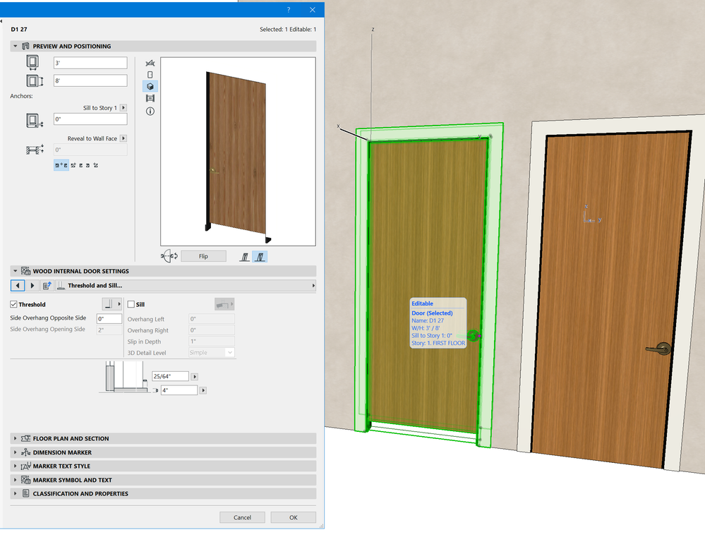

Using the threshold you should be able to accomplish this. The only thing I wish it allowed for was the ability to set it as empty.
For this door, I changed the threshold surface to be AIR, and turned the contours to be white under Floor Plan and Section.

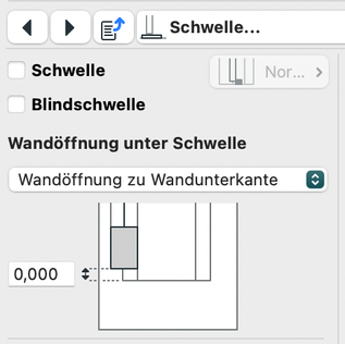

To get the rough opening you could also use this option:
Sorry for the German screenshot. I'm not sure if this is possible with the INT doors or if that was special to the DACH doors. 🤔
But even here this has no effect on the sill height.
