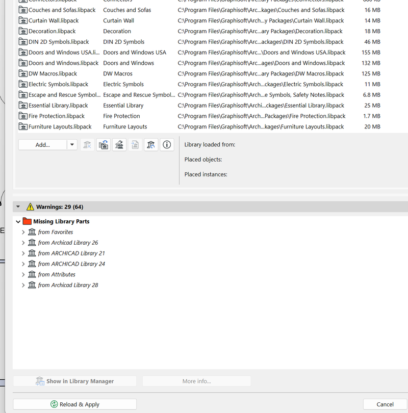

tracking down missing parts is frustrating. Check where they are missing from in the library loading report. Missing from attributes, as in the screen shot below, are easy enough to clean up or replace in the surface manager. Missing from library 'x', you could add that library back in, but most times this results in duplicates. The tedious slog of a solution is to go to the project map, set up a find and select criteria that states:
Element Type is Object
Library part is missing
then go viewpoint by viewpoint to track them down, making sure that all layers, renovation filters, and design options are visible. Once you find them, you can determine if it's more appropriate to relink the missing object to a counterpart in your linked libraries, or to just delete it from the file.

Library item missing:

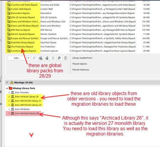

You seem to be opening a file from and older version of Archicad (27 or before) in version 29.
If you are doing this there is no need to load the 28/29 global library packs.
These are not compatible with new files and should only be used if you are starting new file from a version 28 or 29 template.
They can be removed, unless you have started to place objects from these libraries.
If you are opening an older file, just keep loading the old libraries.
In version 27 the main library was call 'Archicad Library 27'.
You need to load that library and the migration libraries if the file was started in a version before 27 - which your file seems to be as it has older objects.
If you still have version 27 installed, you will have these libraries in the 27 program folder.
For some unknown reason, in 28 the version 27 monolith library was renamed as 'Archicad Library 28' - this was a silly and confusing decision by Graphisoft.
It is actually just the version 27 library.
So load that folder and also the migration libraries.
If you don't have version 28 installed and only have version 29, you will find that these older libraries are not included with the default installation (like they are for version 28).

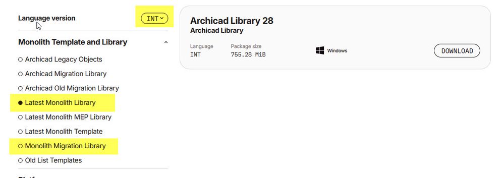

So you either need to install the older versions or you can download just the libraries from here ...
Choose your language version and you need to download the latest monolith library and also the migration library.
Basically, if you are opening an old file, you need to keep using the old libraries.
Do not try to load the new global library packs as well as they are not compatible with the old objects, and it will just become confusing having both libraries loaded at the same time.
