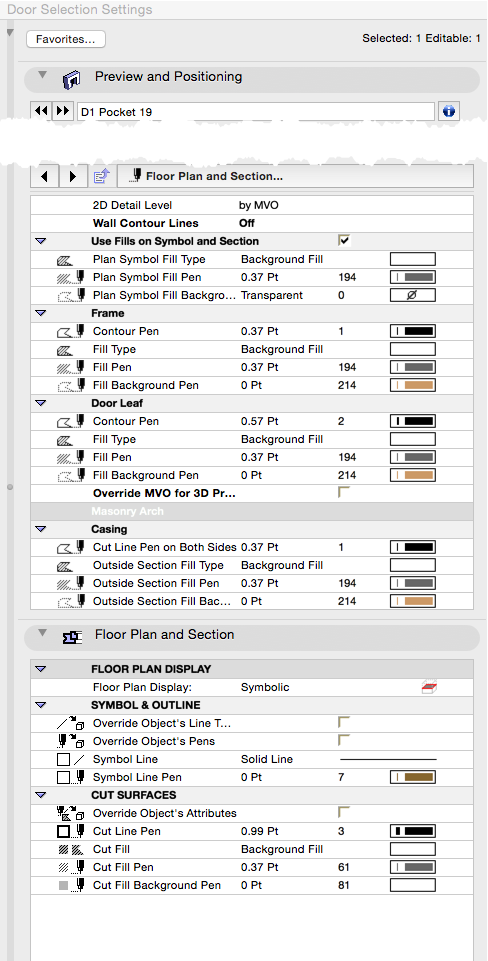

I am unable to determine which parameter controls the fill for the pocket door void in a wall. It seems to be controlled by pen #91, which I have made yellow in the attached image.
My other settings for the doors, composite wall materials and the wall element itself seem fine. I can't find pen #91 anywhere in those settings. Can someone tell me how to turn off the fill in the pocket void?

Look for "Pocket Fill Background Pen" in the "All Parameters" tab.
(Note: my screen shot is from AC18)

Thank you both for your reply; however I need further assistance.
Stress Co: I cannot find any parameters for Pocket Symbol Fill for AC19 D Pocket 19. Perhaps someone using v19 can help me?
Archicad 26 Macbook Pro, Ventura 13.6.3

Thank you for pointing this out. It appears to be a bug in the UI. I will report it to our Library team to fix it in an update. In the meantime, here is a video of a temporary workaround you may use:
