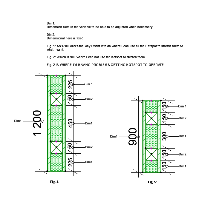

I have some element and on these I will use macro.
When I use the macro I get problem with hotspot2 now I call them.
I can not stretch them now I'm changing dimensions; with (call macro_navn parameter B = 0.900, etc, etc, ..)
See picture in which I explain it a little more.
Someone I an idea of how I solve this
Thank you in advance

If You wish the hotspots in the macro to work You need to have exactly the same parameters names that utilize the hotspots in caller object and the called macro.
Another thing is the hotspot id which have to increase with every hotspot.
