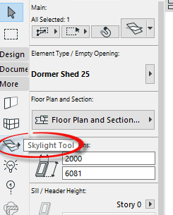

I've got a problem with the native Dormer Shed in Archicad 25 and 28. I think its maximum Shed Roof Pitch value (screenshot) is hardcoded at 35 degrees. This is highly impractical and illogical limitation, and it should be increased to something like 89 deg. Sadly, I can't edit GDL myself, so I'm hoping someone would be able and so kind to try fixing it.
I placed it as skylight but the issue is the same if placed as an object.

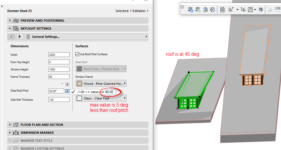

Not sure which library update you are using in AC28, but I am on Update 1 and the maximum pitch is limited to 5 less than the roof pitch.

Are you placing this object on the roof with the sky light tool rather than just as an object?
It should then automatically read the roof pitch and adjust to suit.

When I place the dormer with the sky light tool, the shed roof pitch is limited to 5° less than the actual main roof pitch that you are placing it in.
So please make sure you are using the sky light tool and not the object tool to place the skylight.
I also see it is locked at 35° when using the object tool.
Using the skylight tool, it will also cut a hole in the roof automatically and it will be associated with the roof, automatically reading the roof pitch and adjusting the allowable settings to suit.
If you use the object tool to place it, this will not happen.
