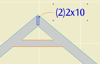

For a wood beam, the user selects the member (e.g., 2x10) and the quantity (e.g., 2). The name of the member is a string parameter, "mem_typ". The quantity is an integer, "qty".
For listing, these two values need to be put together with some other text to build the description of the beam, e.g., (2)2x10. This string is put in the parameter "desList". This is done in the master script with
PARAMETERS desList='('+STR(qty,1,0)+')'+mem_typ
which is just the quantity in parentheses plus the member name. There's no problem listing this.
This is the data I would like to express in the section. Image attached of current method, using a text label.
I would like a label to read the "desList" parameter from the beam object, so when the quantity or the member type is changed (thus changing "desList") the labels in the sections update automatically.
ASSOCLP_PARVALUE seems like the way to go, but so far, no good.
