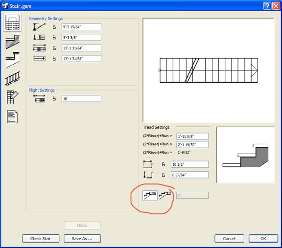

percybigun wrote:You have to click the "Create Stair" button ......
i get a totally different dialogue box to that when i open my stair settings?.

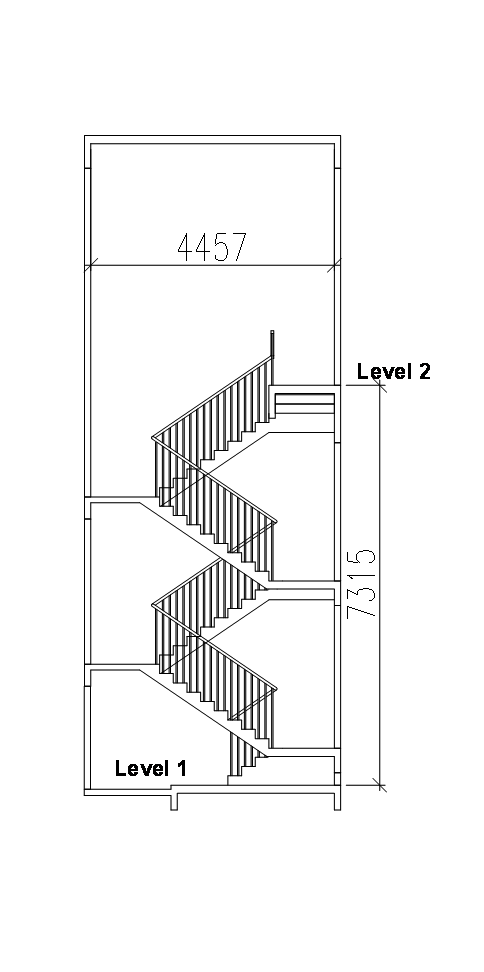

laszlonagy wrote:The quick way to do this would be to use the marquee tool to trim to just this piece at the landing in 3D and save the result as a library part. This could then be placed to connect the separate stairs with SEOs to clean things up as needed.
Yes, they are not connected because they are not part of the same Stair.
I am afraid you will have to create some kind of a custom piece there to connect them.
