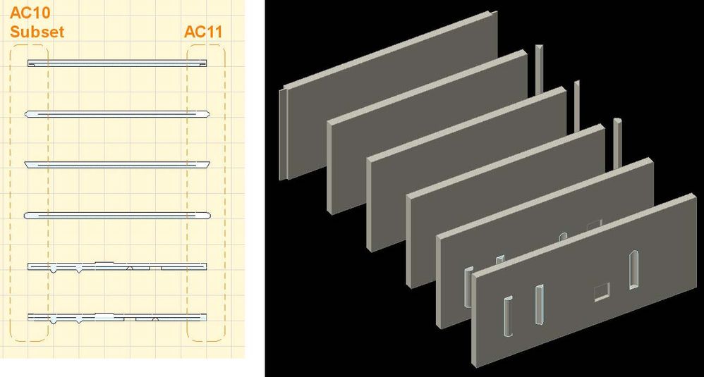

i was just about to write up another issue i'm having with AC11 wall ends: their material no longer merges with the wall material in elevation. i get an ugly, unwanted line at the cut depth length. there is no 3D gap and the materials are most definitely the same.
however! if the wall end cut length is stretched down to the minimum width of the skin that is turned the end of the wall, (quite thin plaster in the case of the screenshot below), the line disappears.
