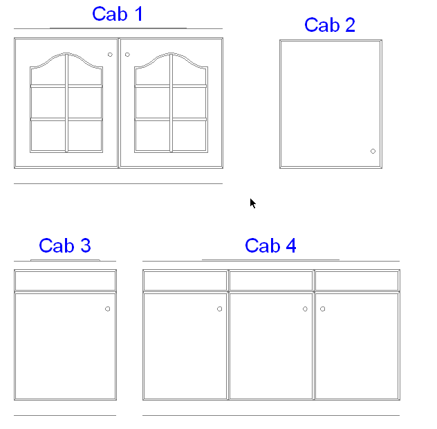

Brian wrote:
/.....Do you know how to hide the pointer?
I'd like to just place the text on the object elevation without the pointer. /..
Brian,
Not sure this will answer your query, but see attached.
Rod Jurich

Hi Brian,
I've dealt with this before. I only had a short time to work on this but I took a Window label that I scripted and adapted it to this situation. It is always going to place the label just above the cabinet (wall or base). If you want it somewhere else you will have to move it (highlight and drag). It's pretty simple as it will only show the ID. (no other options) I've made minor changes to Erika's post (to lazy to type in my own Sorry Erika) as seen below....
First, copy and paste the script below into the 2d script of a new object. Make sure the object subtype is "Label". Save it to your Archicad library as "Cabinet Label 11" (or something to your liking). Make sure it's loaded then use my "Plagerized" instructions below.

1. In the elevation, select all the cabinets.
2. Open the Settings box, and on the Listing and Labeling tab check the 'Label Object' box.
3. Deselect the cabinets, activate the label tool and select all ctrl/cmd +A with label tool active.
4. OPen the Label Selection Settings box, ctrl/cmd +T. In the upper right corner chose the option that says "Cabinet Label 11"(or whatever name that you gave it when you saved it)
4.5 Under the "Symbol" tab make sure the "Use symbol color" and "Use symbol arrow" are both checked.
5. Back in any window, one by one (or in groups of same) select the cabinets and change their ID to W24 or whatever system you want.
This label works for me but if I've made any mistakes in explaining how to set it up for yourself (quite possible...it's getting late) hopefully someone will straighten me out.
