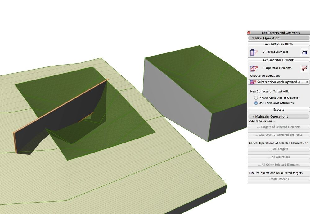

I'm a student learning ArchiCAD, now on AC18. I have an assignment to make a topo site plan using a surveyor's data and the mesh tool. I finally got it down when I found an unattributed .pdf file with decent instructions.
Here's my problem: I need to regrade the site. It should come as no surprise that there are hundreds, maybe thousands of spots on the site that would need to be moved. Is there any way to get a ridge line to move and reshape by moving one spot and having others in the line move in concert?
For example, if I want to create a valley on a hill for water run off, I could grab a spot and pull it uphill with adjacent spots moving to create a nice, smooth curve. The end spots at the property lines would be anchors so there would be a smooth transition to neighboring terrain.
I thought about placing a new polyline on the mesh and space-clicking it. But then what do I do with the line it is to replace? The consensus seems to be there is no easy way to delete a line or group of spots, no less even one spot.

Eduardo Rolon
Easiest solution is to create a New mesh with the new grading and use that to do a SEO (subtract with upwards extrusion) on the original mesh
Thanks, Eduardo. You mean like inserting a dirt roadway mesh with separate countours and elevations into the existing mesh? I'll have to try that out. Even so, it seems harder and/or more time consuming than my idea. Maybe because I'm new to meshes and they take time for me.
I'll let you know how it works out.
