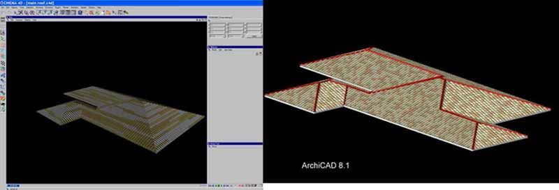

I have exported an ArchiCAD 8.1 Italian tile roof into Cinema 4D 8. the attached picture shows the roof in ArchiCAD with the randomize material option on, but when I import into Cinema the tiles do not randomize, but sort of get into rows.
I think the randomize option makes it look more realistic.
Does anyone know why I get this problem?

I guess randomise is just an internal trick for the ArchiCAD renderer. I guess it doesn't export into correct texture-coordinates for OBJ/3ds files, so that would explain why this isn't exported into Cinema4D.
And if you export through DXF, texture mapping won't be translated at all, so there is no way any ArchiCAD-texture mapping information will survive the translation.
