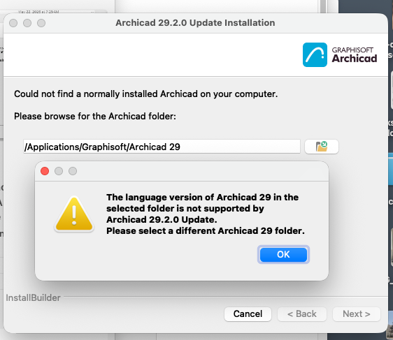

I'm trying to install 29.2.0 but getting this message.  Advice?
Dave Brach/architect AC28 Macbook M4 Pro OS Sequoia
Lee Hankins
You need to make sure you have downloaded the correct language version of the update for the language version you have installed. The update Previews aren't always available in all language versions.
