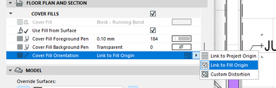

I will try my best to explain the issue with fills I have.
We add fills on top of elevations, for tiles it’s important that the fills (tile size) is layer out logically.  By logically I mean that if I have space 24x12, and I use tile that is 24x12, that it will use for that space only one tile instead of two.
so far I tried all different “layout options” from the archicad selection but neither one would fit the tile in the space that is designed for the tile. It’s important for us for the tile to be well layed out so the trades understand it, they would not guess it’s random and would make mistakes.
if the fills aren’t working like this we would have to do all of this manually, and then I could as well just use sketchup for free ..
does anyone have solution for this?
 in photo attached the tile is as mentioned 12x24” and the width for the space is 24”, so why it doesn’t show just one tile?? (Layout setting/spread doesn’t help)

1 ACCEPTED SOLUTION
Solution
You can use the fill handle to reposition the hatch pattern and also rotate it.
The construction method with 2 handles allows you to also stretch the lengths and distort the angle of the hatch.
1000mm long handle equals one hatch unit size, 2000mm long equals 2x unit size

This is easily achievable:
turn on fill handle display
set fill origin to 'Link to Fill Origin'
drag origin to where you want the fill pattern to start
Regards,
Scott

hi! Thank you for your response! I followed all, including turning on the fill handles which I hadn’t had on. But not working :/// this is what happends when I set it up to origin, and I confirm the tile is 24x12 .. I also tried the other options to layout … still showing 2 tiles instead of just one .  how come? 😞

I would go into the fill setting and check the grid size that has been set for the fill. One other thing to note which isn't a big thing, you have it set to cut fill, rather than cover fill. May not change things unless you have graphic overrides set up for specific views.

thank you for letting me know! I am not as far as graphic overrides yet lol 😄 I looked at the tile setting and this is what I got. Do you see anything unusual that can affect the way the layout is laid?:D

When you want a scaled hatch pattern like tiles, you want the fill to be set as "Scale with Plan"
Then the pattern size should be set to reflect the size of the tile.
