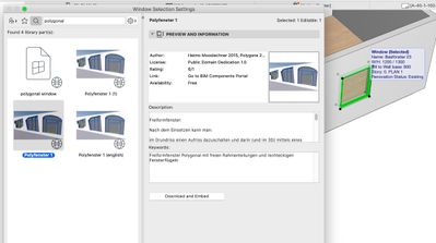

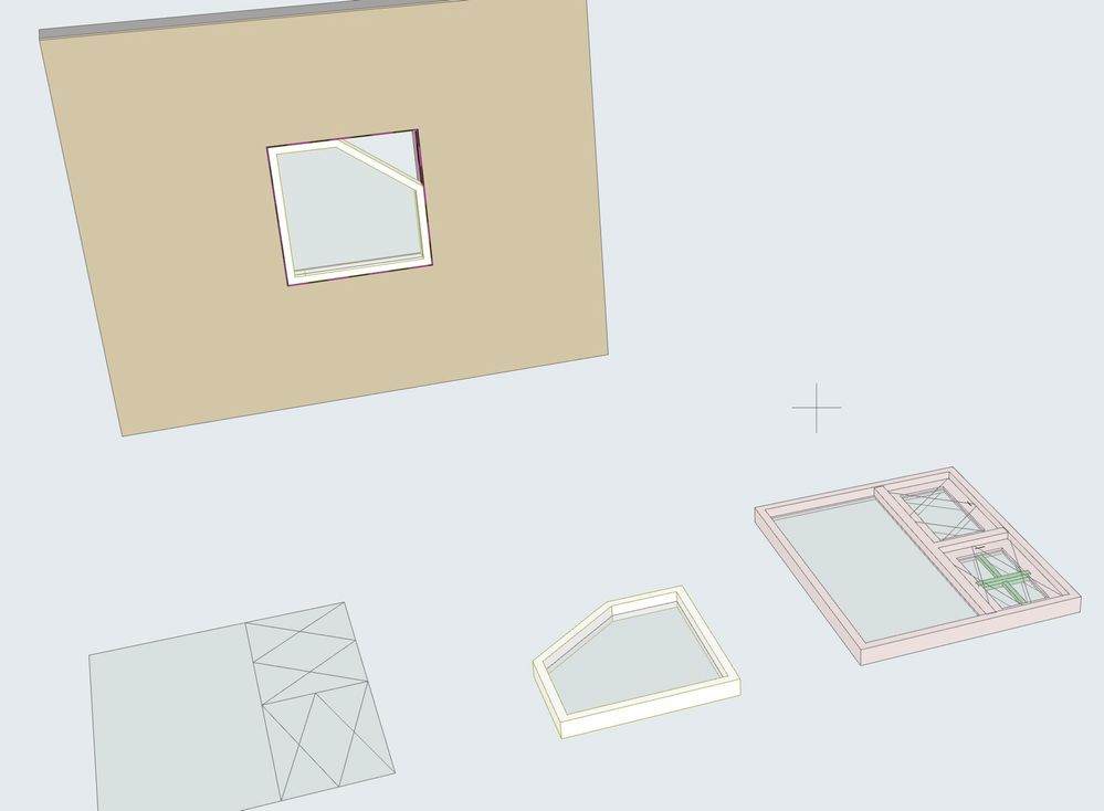

Hi I'm struggling to design this simple but atypical window. do you have some recommendation how to reach this shape ?

The trick to get the hole to match the frame is to add a slab that is the overall shape of the window and give it an ID of WALLHOLE.
Then when you save it all as a window object, it will automatically create the correct shaped wall hole from that slab.
Jop You are right I din't get it that I have to be on windows settings.
But unfortunately there is non description how to reach this tape of window 😕

The first one with no image seems to be in English (2 & 3 are German I believe).
The 4th one, I got an error message when trying to download.
Just select and then press Download button.
It will be added to your Embedded Library.
As I said, I have not used this object but is is all stretchy in elevation and even a preview in plan by the looks.
There seem to be some description in the plan preview for what to do.
There will be a video by the creator @Hmooslechner somewhere in a post here.
I think this is the post with a link to a YouTube video.
https://community.graphisoft.com/t5/Design-forum/Polygonal-freeform-Window-with-inner-freeform-grid/...
