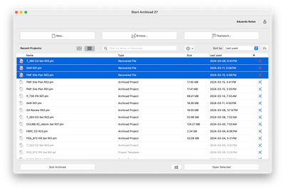

As a heads up this is unnecessary and not correct.
If you have multiple ACs that crash next time you open AC you can select all of them by shift clicking and click "Open Selected".
Any one you don't need you can click the red "X" to remove from the list.
