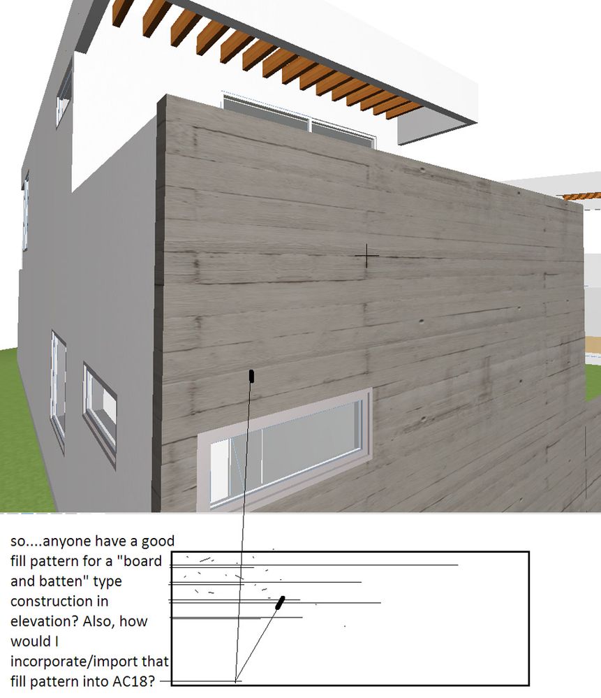

if anybody has created this fill type already, surely would like some guidance on how they did it.
We have a "board and batten" type fill which needs to be represented in elevation.
see attached image.
was thinking something simple, perhaps one or two lines to designate the boards, with stipple type graphics to designate concrete.
How best to achieve this fill creation?

Can't really tell what you want, Rob. Board & Batten is typically a vertical installation... horizontal would require top z-flashing for every batten...?

Sorry...perhaps I misnamed the pattern I was looking for. "Batten"? perhaps is what I was looking for?
it's the surface texture which has horizontal lines and parts of the concrete seep thru the horizontal boards. Gives the rough concrete surface an interesting look where the wood grain sometimes is seen "IN" the poured concrete surface itself.
I'd call that "Board Formed Concrete"

That's it...."Board Formed Concrete"....sorry my bad.
Thanks sir.

Steve Jepson
Bump in rendering is how to do that.
